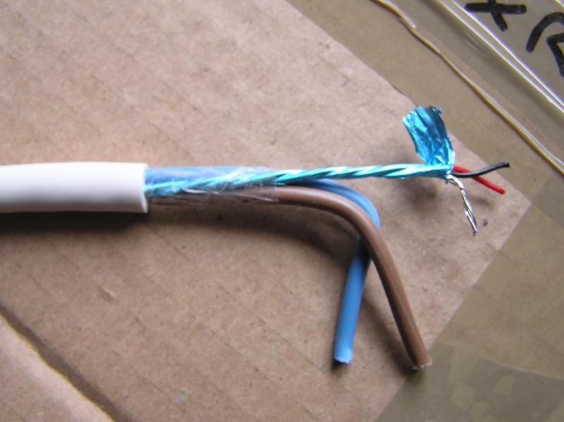

A major clearout at work netted me two big reels of 3-core flex for the price of lugging it home.
Great - however on further inspection,inside the thick white insulation there are blue and brown copper stranded cores at about 4mm - but no earth core.
Instead there is what appears to be a data conductor.
It is a twisted pair of,say 0.5mm, silver stranded wires in red and black insulation and a bare common wire all bound in a foil screen.
What is this stuff supposed to be used for? - no one at work knows.It appeared at around the time we had some camera work done,but the contractors didnt take it with them.
Is there a use for it in domestic situation - perhaps lighting?
Power-plus-data cable, probably used at you place to provide power to the cameras and bring data / image back from them in a single cable.
Can be used to control remote lighting equipment as well without the need for a separate switched live wire for each lamp.
Similar cable has been used where a covert monitoring device has been installed in say a table lamp or other item where two cables would show the lamp was not just a lamp.
so Id be ok to loop some downlighters with it then?
No.... because to supply fixed installation mains lamps the cable must also, provide an effective earth conductor even if the lamps being fitted do not need an earth.
For portable lamps that are double insulated it could be used.
