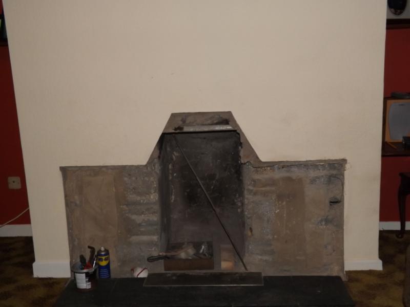

Hi all. I've a question that I'd like opinion on. See photos below for reference.

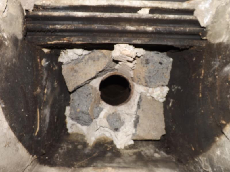

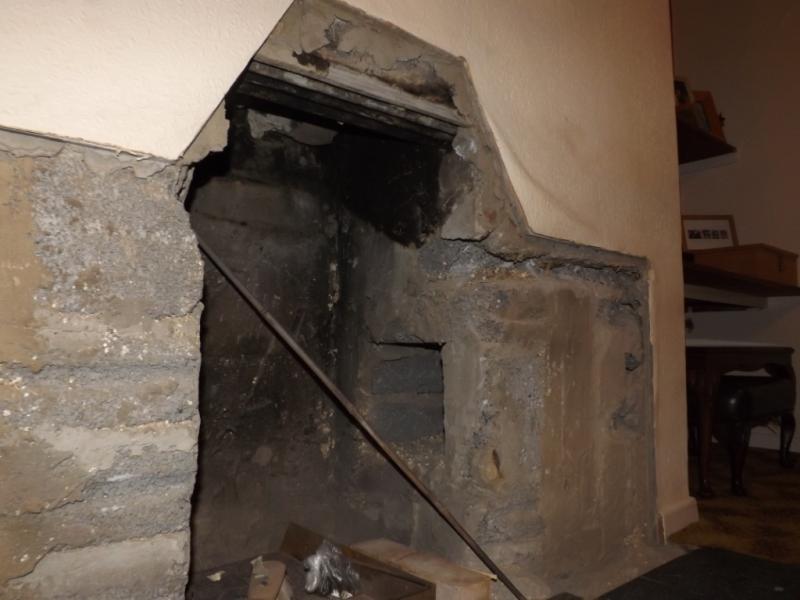

I want to insert a wood burner into my existing 1960's chimney breast. I removed an old rayburn rhapsody 401 and have cleaned out the whole space, not removed any bricks yet. (I've exposed a big void/gap on the right where back boiler pipes were).
The brest goes to ceiling height at 74" width, then narrows to 32" up to the roof. The brest is 32" deep.
There's a metal lintel 38" wide centered to the original opening and from the floor to its underside it's 30".
In a nutshell I want to insert an ash beam (6"x 6"x maximum width) at about 46" height and open up the underside, removing the existing metal lintel.

Whilst Ash is a fantastic strong timber I wouldn't use it as a supporting head.
I did one a while back and the first thing I did was thunder bolt a heavy channel iron section across the chimney breast. Then two small acrow props pushing up.
Then you can jack hammer away with confidence.
Then a concrete cast was formed in situ to form the head (which was re barred) and chimney liner support base all in a single pour.

Thanks for the advice Norcon. From what you are saying 6x6 ash beam (dried - thanks AronSearle), even though is strong, cannot be trusted, so I'd need to insert a lintel of sorts (thanks noseall) above? we are after the beam look and would like not to have to insert both.
What widths would you recommend, bearing in mind the measurements in my original post?
A thought - could I insert a lintel behind a wooden beam, leaving the beam exposed? Or is that pointless?
