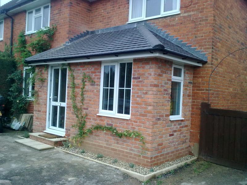

Would have thought dog kennel would have been finished by now.
Cheers oldun. What can I say, I'm a slow worker! I think we had it plastered and 'finished' in around late November but then got distracted by Christmas. So now I need to sort the final loose ends to get BCO sign off - things like installing loft insulation, and the soakway pipe.
I don't have any pics of the inside unfortunately, but the old front door opening has been opened up by 20cm either side, so it's really transformed the downstairs/lobby area of the house.
We've acid cleaned the bricks since this photo so the brick colour match is a bit better. As you can see, I went with a hip end at either end of the roof... what a pain that was!
