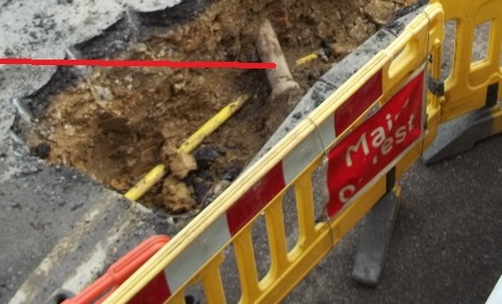

(2) This mystery sewer / drain pipe was discovered when the gas pipes in the village were being replaced.
It appears to head uphill under the pavement directly towards the lounge of my cottage. ( bottom of picture ) and slope down towards the High Street ( top of picture ) and possibly the main sewer.
It is however not mentioned on any of the data / plans / documents for the area.
A bit more excavation uncovered a bend in the pipe that turned it away from the cottage, Through a crack in this elbow it could be seen that the pipe was half full of mud/sludge. Anglian Water came out and decided it was probably a redundant drain that might still be connected to the main drains but without getting a camera into the pipe they could not give a definitive answer.
It is now buried.
