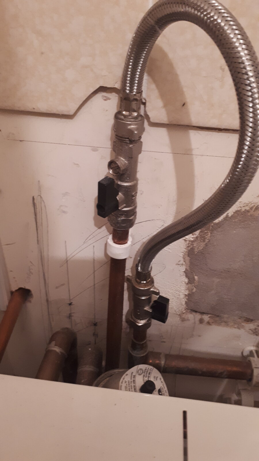

I would love that to be true Harry, but I am fairly sure (not 100% mind...) that the meter measures in cubic metres - so 240 to 272 is a f*&^load of water... enough to fill a 5m by 3m pool to a depth of 2m.. It seems a lot doesn't it...

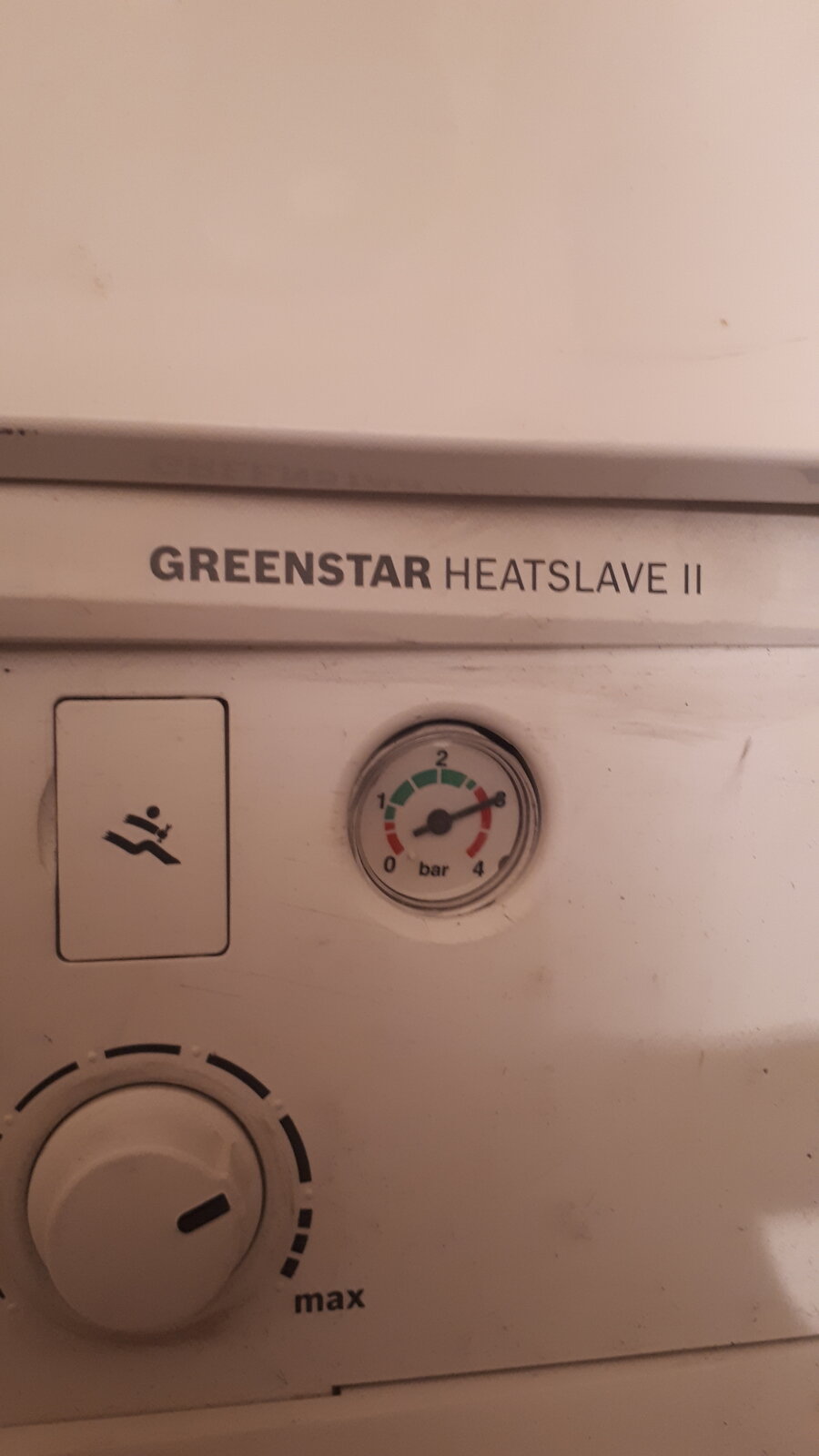

They should be closed. Close them off, bleed some water out of the rad until you get the correct pressure and see how that goes.

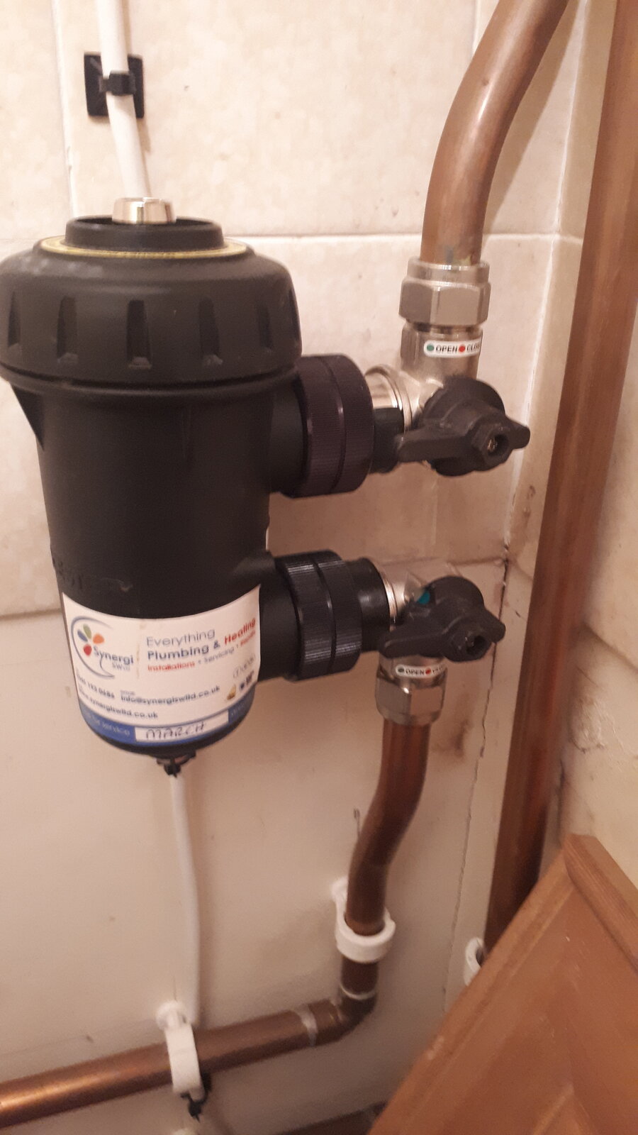

Don't think so, but drips all the time.. I thought briefly it was condensate pipe (don't laugh) but the large rust patch where the water flows against the wall disabused me of that fleeting notion. I should imagine when the pump is on the water flows in and almost straight out again... well, not straight out, because it's well heated when it ****es out of that pipe, which annoys me on two fronts - wasting water and hot water at that...
Good odds (from the sound of the unmaintained state of the heating) that the expansion vessel is either shot or flat- soon as you warm that 2.5bar water it'll be straight up to 3 plus and the prv does its job...as above, switch filling loop off at both ends, if you can easily disconnect one end then do so (shows whether the valves are passing even when off)- make sure you know where the main stoptap and have buckets handy before you do that in case you get a flood. Then bleed a rad til the pressure drops to 1 and a bit. Then fire the boiler up and watch the pressure gauge (and the prv).

Close both black lever valves ,on the silver braided hose, your filling loop is open.
You then need to drain water out ,via a radiator ,or drain cock ,to get pressure down to 1 bar ( when system is cold).
The PRV will probably need replacing ,and the expansion Vessel checking out.
