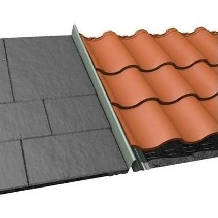

Or you could use a bonding gutter:
You'd need to re hole , and they likely not sit good. And you would need to cut to get the bond .
Bonding strip would work .
You can get cement fibres in 250 x 500
