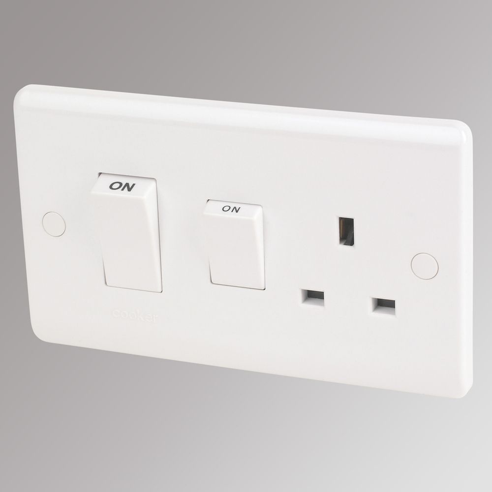

Hi,
I have a washing machine which needs to be plugged in under a worktop.
Above the worktop is an existing double plug socket.
I am wondering whether using a cooker switch like this one:
ae235
can be used to switch a sub worktop plug socket?
If yes, then it will save me having to chase out a new single fused spur above the worktop.
Just to be clear, the cooker switch would be fitted in place of the existing double socket on the standard ring main, not from a 45A cooker circuit, from which I'd spur off to an unswitched socket below the worktop.
As far as I know no regulation to say this can't be done. Before Part P I would worry that some one may in the future think this switch has a cooker supply and would in the future fit a cooker in error.
However now that either a scheme member electrician or the LABC have to be involved that should not be a problem with all the work registered with the LABC. However where you have the problem is convincing the scheme member electrician this. It is up to him what he will do.
Although you can use the LABC that would be more expensive than using a scheme member electrician.
Thanks. It was whether there was any technical reason that it wouldn't work which I was after. I'll be doing the work myself and not notifying it (sorry guys).
As far as I can see its no different to having a single above worktop 20A switch with an unswitched socket below. Someone should do a double gang 20A switch with a socket, which is essentially what I'm after.
Actually just noticed these:
ae235
which would allow me a single socket and single 20A switch in one. Do these fit into the space of a double gang backbox?
Well, personally, I think you can't do it and comply.
Quite separately, it's not going to save any chasing as you'd need to dig out the box and fit a 47 (or 35) mm box (depending upon the switch).
It will NOT fit in a 25mm back box!
Using the switch to control a socket below is fine off a ring final, but having an additional socket built in? I don't think it would pass muster.
If the unit was fed by a 30A radial, no worries, but by a ring final, no, I don't think it would be OK.
Why? Whats the difference between this and a standard spur socket taken off an existing socket?
I'll check the depth of the existing backbox before I do it. The socket in question will also be mounted over tiles which will help with depth.
I know the aesthetics aren't fantastic but wouldn't a small hole hard up against the wall/tiles and feed the wash m/c cable through that, attach plug. Bob's yer Mams bro!
Do you need the switch readily accessible?
In the event that the washing machine throws a hissy fit, can you not just flip the MCB?

I'm just thinking about potential loading on the circuit that's all.
Don't forget, regs say 2kW+ appliances should have their own circuit rather than occupy a ring final.
