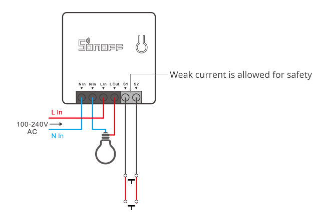

Hi guys
My brother in law has bought me a bunch of sonoff mini smart switch modules and invited me round to his house to show me how he has wired them up.
Please note the following diagram from the manufacturer to wire a 2 way switch to the smart relay:
https://community-assets.home-assis.../d04531ec59ede1c19890a702dd8e0ad668d1e0d7.png
Basically it requires 3 wires between the second switch and the first switch/relay.
My brother in law only has twin and earth between both switches so he's used the earth cable as the third wire, despite the fact it is unshielded and there is only the pvc jacket protecting it.
I challenged him about this but he said there is no mains voltage running through the wire. Its just a dry contact switch.
There are other cables coming into his back plate so the backbox is appropriately earthed.
I still felt uneasy about this so went home and had a look at my wiring.
Sods law states there is only twin and earth between my 2 way switches too.
I've had a quick Google search and he's right about it being a dry switch but I'm not sure if he should be using unshielded cable for this purpose.
What do you guys think?
How concerned should I be about my brother in laws wiring?
I'm not sure how far I should push him about this. He knows a little bit more about electrics than I do so I'm mindful about not wanting to be teaching him how to suck on eggs.
Thanks in advance
CF

You can't just connect a switch to a relay coil and have it turn a relay on, there has to be some form of power to the control circuit. Given the wiring diagrams show no external source of power to the control circuit power must be coming from inside the sonoff unit.
It's possible that sonoff used a power supply that is safely isolated from the mains, but it's equally possible that they used a power supply that is not isolated at all, or that they used a power supply that is notionally isolated but is not approved to any safety standards. In the absense of documentation you have to assume it is not isolated.

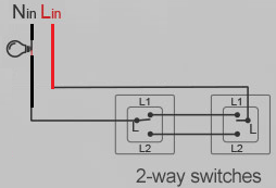

However, and just like any light switch, one side of that wiring will need to be connected to the power and the other will be connected to a load, such as this very standard domestic light arrangement:

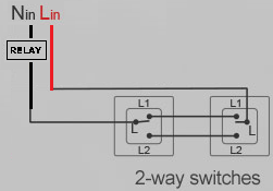

The Sonoff unit will be replicating that in some way such as operate a mains voltage relay:

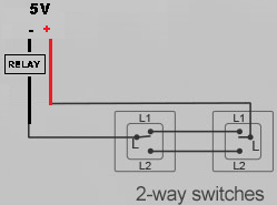

It may very well be working at a safe extra low voltage (SELV) such as this with 5volts DC (just as an example):

Sorry but no.
The fact that the measured voltage between the two switch inputs is only 3.3V does not in any way imply what voltages may be present between the input terminals and other terminals, or the safety ratings of any isolation barriers.
It's perfectly possible to have a 3.3V logic supply that is referenced to mains!
Just found pictures of the internal PCB from the sonoff mini and as I suspected there don't appear to be any power isolation components. Looks like a bridge rectifier followed by a non-isolated buck converter to provide the logic supply.
So you should definitely treat the switch wiring as mains wiring.

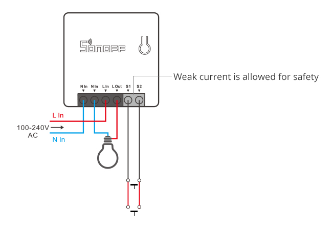

I think I might have sussed out another way to make this work using momentary switches. You can set the sonoff at software level to recognise a momentary switch as an 'ON' signal. The following schematic will allow me to connect both switches with the pre-existing twin and earth. I'll just have to replace my standard switches with momentary switches:
Going back to my brother-in-law. I'll try to feed this back to him.
To make sure I've understood correctly... he shouldn't use the unshielded earth because the mains voltage could jump from the live terminal to S1 and S2. Is this correct?
