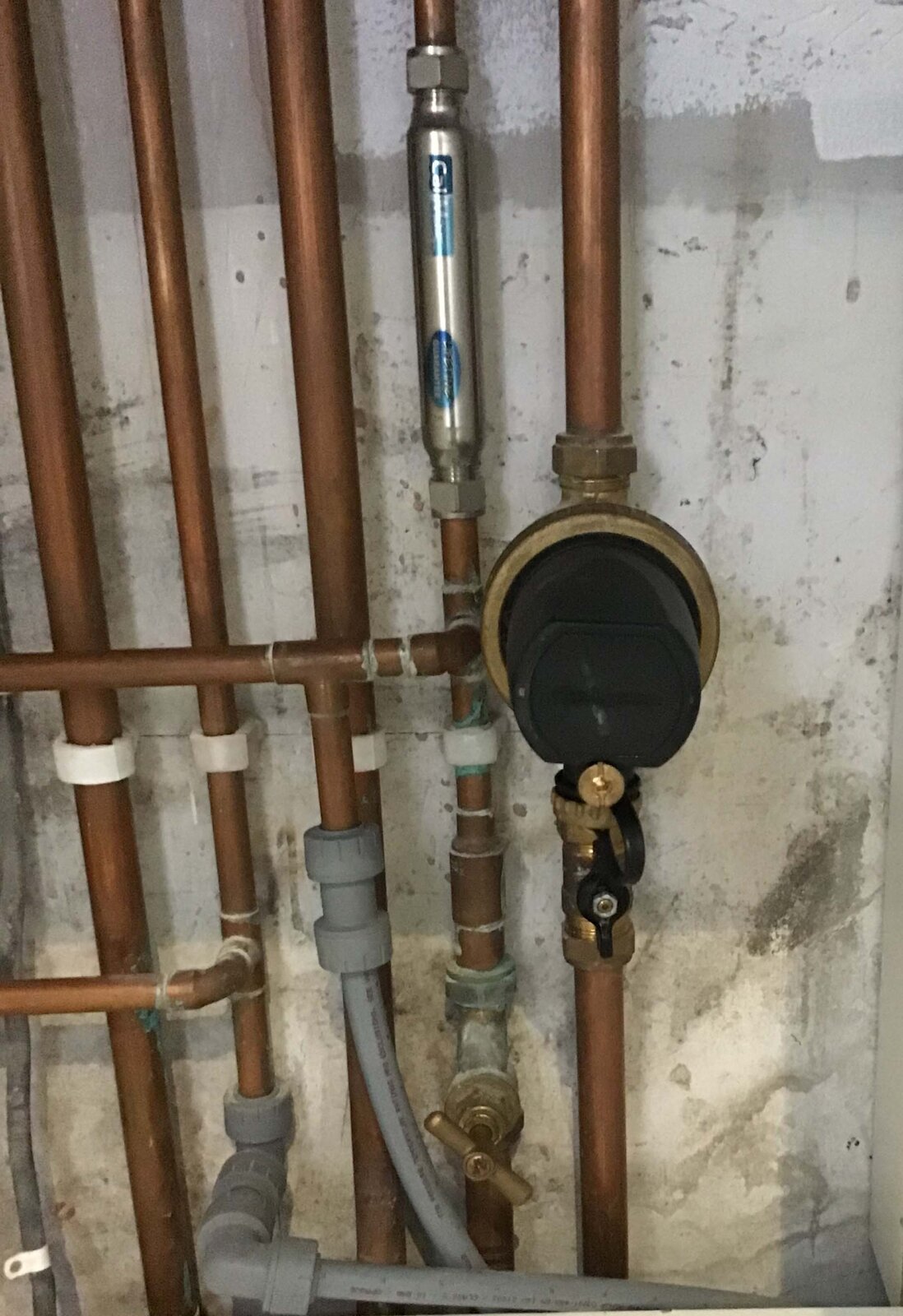

Removing an olive from some 15mm pipe will be very difficult. We are aware of the options such as olive puller, sawing off etc but we want to try and use a new isolator valve with the old olive in place as a first attempt. My friend who has done this before has used LS-X (probably because this is what is in his tool box) to help the olive re-seal.
If I was going to doing it, I would go for PTFE tape as it has a thicker physical presence and is squashable but I have read that PTFE isn't the optimal solution to this.
Should we use LS-X, PTFE tape or some other compound for the compression joint in this unavoidable scenario ?
Thank you.

1. It might help if you could provide a photograph showing what you are trying to disconnect / replace.

Want to remove the useless scale reducer and put in an isolator, none return valve and mini expansion vessel.
The only room we have is the space to right of the pipes. We need to use a full flow 22mm none return valve so as to not reduce flow to the combi too much. The cold water pipe leaving the scale reducer is not accessible as it disappears behind a tiled box section before entering the boiler. The boiler installation is neat (in kitchen) but all very tight.
Plan is the put a couple of 15mm compression couplers where the scale reducer is and put the new pipe work in the space on the right using large radius pipe bends to keep a good flow rate. We might not be able to remove the olives and I am very cautious of damaging the small amount of copper coming of the bottom tee joint.

Is PTFE and LS-X viable .... or something that's just not done ?
Just tighten it up as you would normally do.
Then if it leaks use other methods.
If it's not been deformed by overtightening it will be fine without anything else.
Have to disagree - if a new fitting is used on an old olive, experience has shown that the end that doesn't twist and re-shape the olive surface, i.e the new fitting's fluted end sometime doesn't sit on olive the same way as the last fitting did and it can weep. For all it takes to put a wrap or 2 of tape to remove that risk and a bit of grief.
That's why I said to try it first and check if it weeps.
2 minutes job possibly avoiding the mess of paste or ptfe tape.
Nah, why bother, there's no mess sticking on a wrap or 2 of tape around the olive and it avoids the extra minutes of isolating and draining down again, especially for a DIY'er, who then may worry about a fitting that's leaked as to whether it will do it again.
