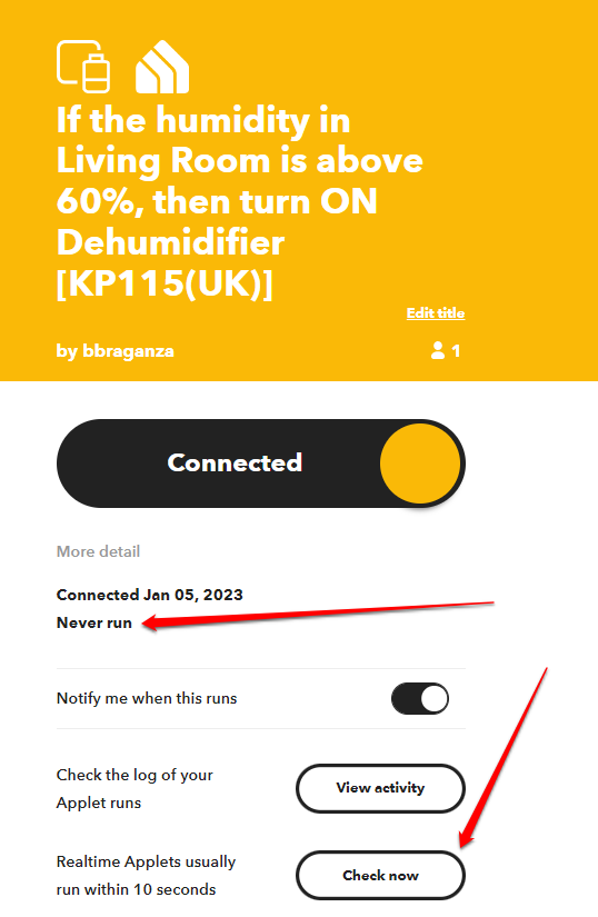

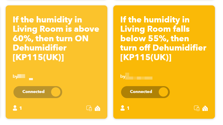

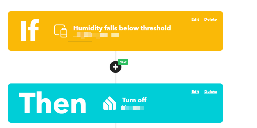

Has anyone here tried to use Humidity sensor on Tado TRV to control Kasa Smart Plug to run the Dehumidifier. I have tried with Alexa but I cannot create a routine with the tado humidity sensor ( they do not seem to be available as an option to select). What I am ideally looking for is to create a routine to turn ON the Smart plug when the humidity sensor reaches above 60% and turn OFF the Smart plug when the humidity sensor reaches below 55%.
I did also try with IFTTT, and the good thing is it does allow you to create an applet with all necessary details (TRV Room name = Living Room as updated in TADO)but its never triggered even when the conditions are met. The applet seems to never run even when forced to run using "check now". The sensors for some reason do not seem to report any back. delinking and linking the account again also does not help.
Has anybody got this working?

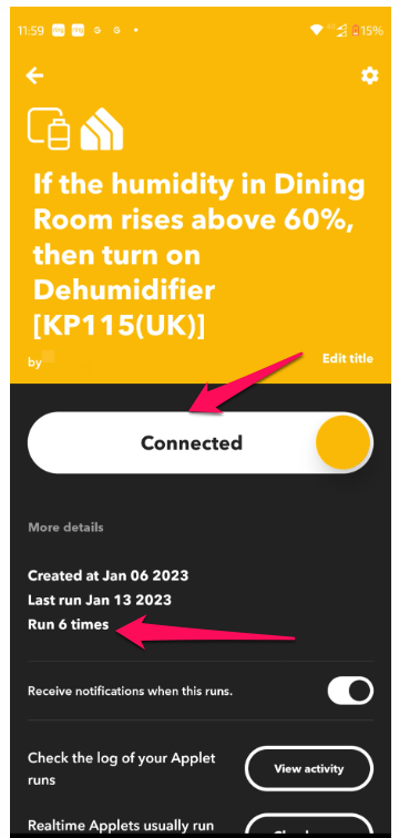

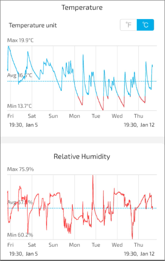

IFTTT seems to be working well now after I tried disconnecting and connecting the applet again. I agree with you that we can't rely on tado values 100% but at least it gives us a baseline. I use Govee Bluetooth Hygrometer Thermometer H5075- They are great and quite accurate. You are also able to view the history of temperature and relative humidity records at a specific location using graphs. The only issue is I can't run automation/routines based on the values. They do offer WiFi-based Hygrometer, but haven't tested it. I'm sure you would be able to run some routines in Alexa. Need to test that one.
