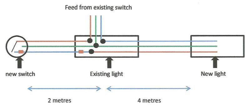

The new switch will be in an opposite direction to the new light. The easiest and most convenient way of wiring the new light and switch is to take a feed from the existing fitting to a switch, then back to the fitting and then onto the new light. So a T+E from existing fitting to switch, then T+E from existing fitting to new light. If the junctions could be housed in the existing fitting it would be a neat soulution. If not, then I will install a separate junction box.
It's really whether it's considered ok to house connections in a light fitting that have no direct relation to that light.
Ah - now I see.
That won't use any less cable than running a cable from the existing light to the new one, and then from the new light direct to the switch, so why not just do that?
From the viewpoint of the internal garage door, the new light will be approx 4 metres beyond the existing light, but the new switch will be approx 2 metres this side of the existing light. The main garage light switch is not in the garage, it is in an adjacent utility room with hidden cabling until the existing light fitting.
So, one T+E (as feed to new switch and return, suitably identified) from existing fitting to new switch; then T+E from existing fitting, picking up the new switched live and a neutral, to the new light.
So as a cable run, it makes sense to make junctions at the existing light fitting.
I was thinking more along the lines of this...
(existing light connections omitted for clarity)
There is nothing wrong in making additional connection within enclosures of fittings or accessories, providing the it is related to the circuit of that fitting/accessory.
Ok, that's what I wanted to know, many thanks.
