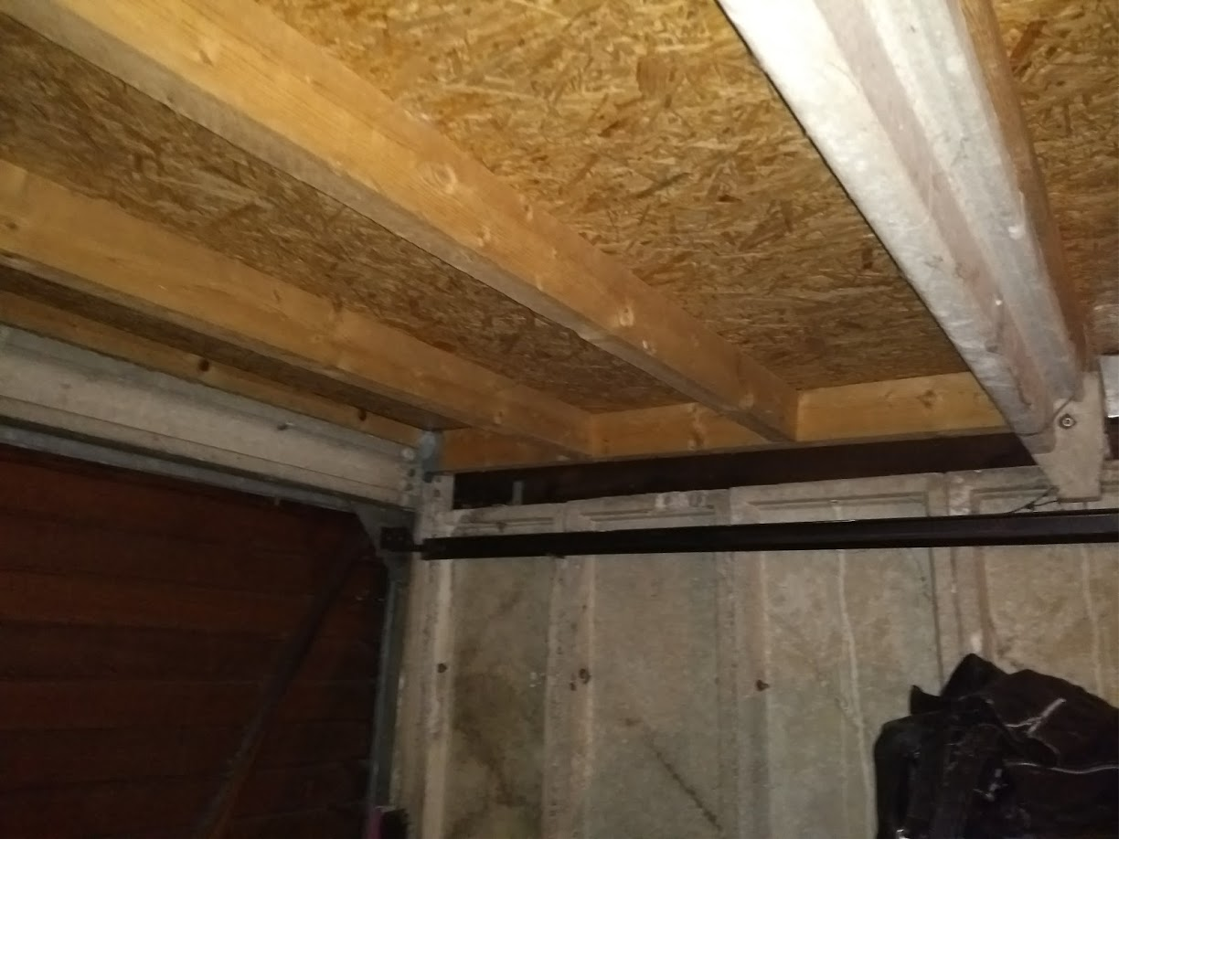

I have a concrete sectional garage that I need to remove to make way for an extension I am having built. I am still renovating a room that needs to be carpeted before I dump furniture from the garage into it, so cannot knock it down right now. The clock is ticking fast now ... building due to start on April 8th.
If I don't get the garage down by then, could my builder use the concrete in the walls and roof beams in the foundations or concrete slab, topping up, filling in, with fresh. The garage is in good condition. Is all concrete equal? This might kill two birds with one stone - save me removing the garage, and save a little on concrete too.

I wouldn't, I'd be thinking unless you proper crushed it you would be left with voids. Others might think different.
If you didn't sell it could you stack it somewhere?
I doubt you'd find an SE to agree to it! If you smashed then up enough you could mix into the concrete

Well, my builder says no, si that's that. Gotta sell it! I do have room to stack it, but then, I'd need to pay someone to take it down and stack it!
They only have a couple of bolts on each section don't they?
Yeah, but looks more than a diy job. The roof looks the trickiest part. Will try to sell.
Make sure the roof is not asbestos boards, more tricky to dispose of if it is
Sell it, the travelers love these as they sell them to old people for about £10k.
Don't bother trying to undo the bolts... waste of time on something like that .. Angle grinder!
roof is chipboard.
and bolts... dont look too bad?
