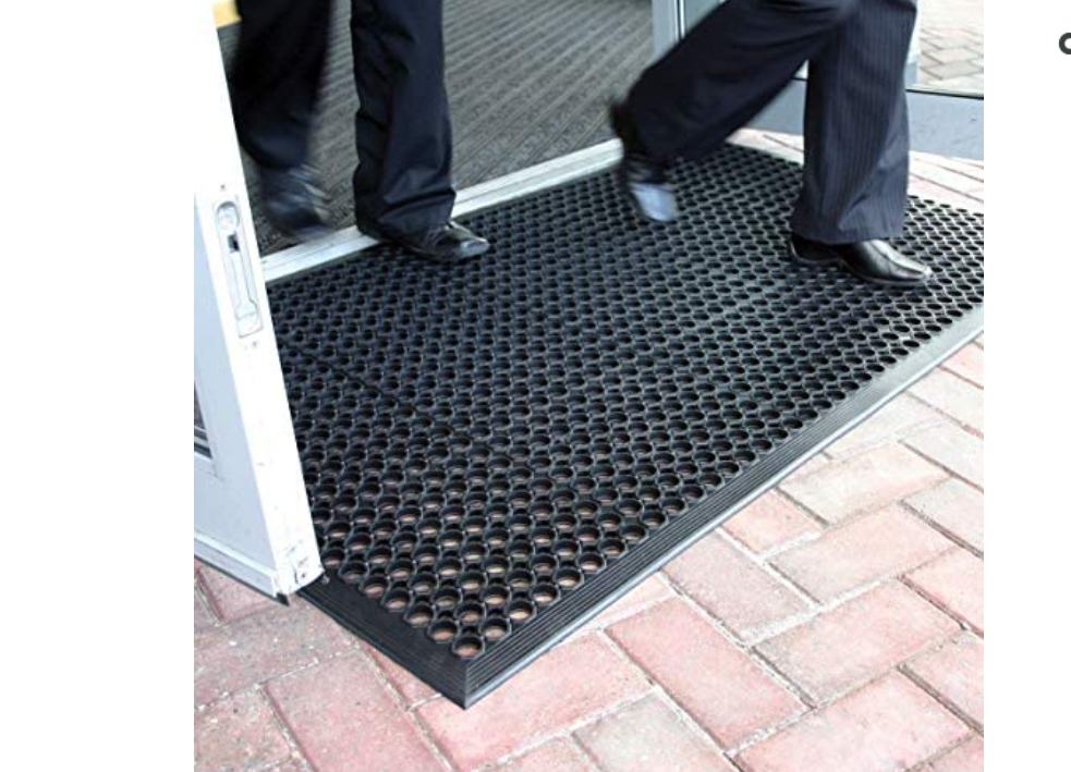

I've often thought that something as simple as a large rubber mat would do the job:
I don't think it's a problem for professional roofers who can run around a roof, know which part of a tile will hold their weight etc but as a (17st) Diyer, I managed to crack a couple of tiles with my knee when doing my roof. I also found it quite a strain on the muscles and a distraction trying to find a comfortable working position - either sitting or kneeling. Got to be better than some diyers chucking an old mattress up there to work off!
I see no reason why this would work very well. I have one of these mats in my garden, to prevent slipping on a sloped bit of lawn, and it won't spread your load much at all.
