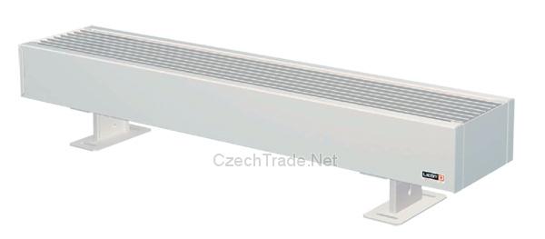

i fitted a model in my parents airing cupboard and it works well (for airing though). I think it was a Licon floor standing unit and measured about 350L * 200W * 250H. (similar to the unit in the image below). you could also consider slim line skirting heaters if wall or floor units dont work.
