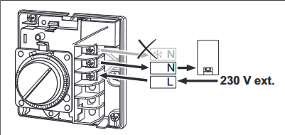

Unless you can just get the relay (receiver) for your thermostat, it would seem you will need to replace both the stat. and the relay (receiver) as it sounds like the relay has gone short circuit.
It could be a wiring issue.
Sometimes installers forget to remove link between no 3 and 4.
Worth checking
Worth checking
Would this link be in the reciever or within the boiler?
In the boiler, but often 3 and 4 are used anyway. Sounds like the thermostat may not be connected at the boiler end, or has been linked out.

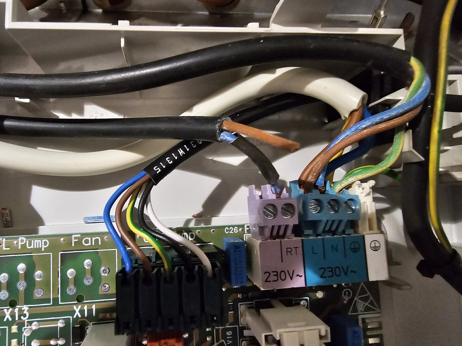

I checked my boiler today. And here are some of the images-

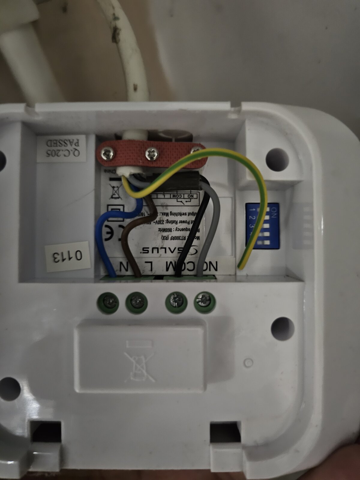

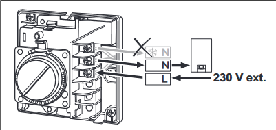

1. The reciever wiring:
The L and Com are connected to the live wire within the boiler.

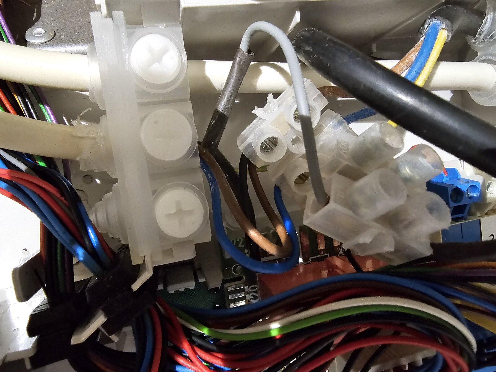

2. The wiring within the boiler:

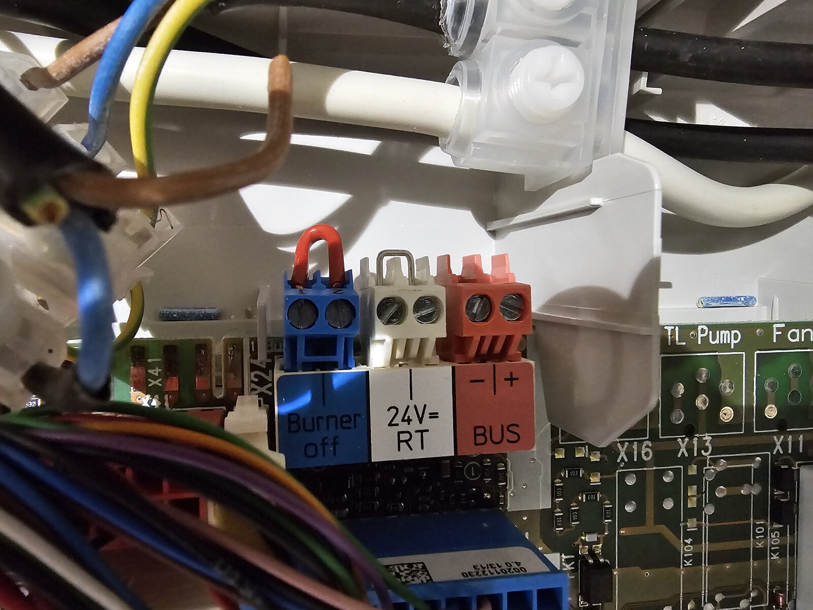

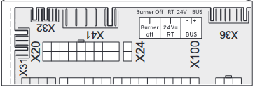

3. I see a loop connection on the 24V rt. Should I remove this loop?
Any thoughts what might be going wrong? Thanks in advance for all your help!

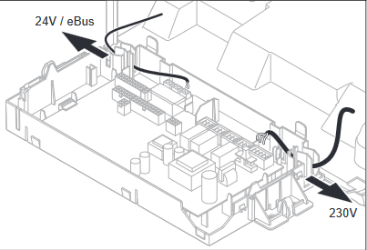

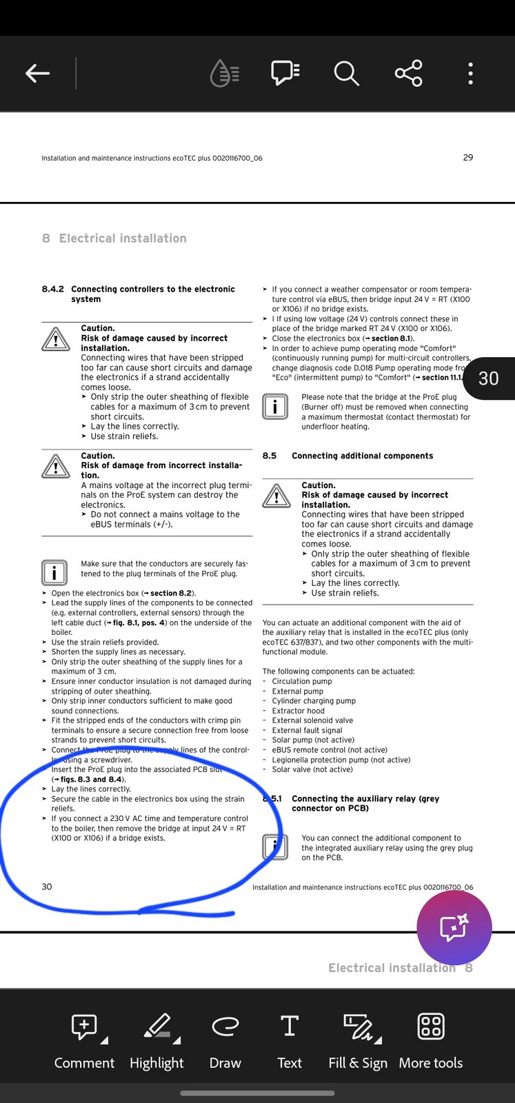

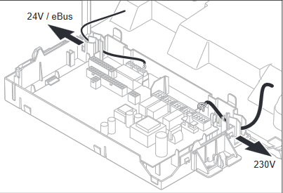

I tried to look for the boiler manual at first found wrong one, but when I did find one which seems to match pictures it does give some warning.
It says how the 24 volts and eBus must be independent cables from the 230 volt cables, including coming out of the boiler on different sides.
It seems nothing is connected to your extra low voltage connections. So you are looking at page 37. This is an unusual instruction
However reading the instructions it says
this makes me think the termial block is room sealed, yes I agree a silly idea, but I would say you need a gas safe registored person with the equipment to test to ensure the seal is intact before running the boiler again, as an electrical engineer that 9 rings alarm bells, and I would simply walk away and say it needs a gas safe person to work on it.
I am sure some one will come and confirm or otherwise to if on this boiler one can access the wiring.
I tried to look for the boiler manual at first found wrong one, but when I did find one which seems to match pictures it does give some warning. View attachment 350003 It says how the 24 volts and eBus must be independent cables from the 230 volt cables, including coming out of the boiler on different sides. View attachment 350004It seems nothing is connected to your extra low voltage connections. So you are looking at page 37. This is an unusual instruction View attachment 350005 View attachment 350006 View attachment 350008 However reading the instructions it says View attachment 350009 this makes me think the termial block is room sealed, yes I agree a silly idea, but I would say you need a gas safe registored person with the equipment to test to ensure the seal is intact before running the boiler again, as an electrical engineer that 9 rings alarm bells, and I would simply walk away and say it needs a gas safe person to work on it.

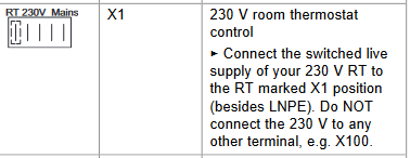

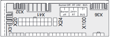

Thanks. I think I got my hand on the right manual now. Below is the screenshot of the same-
I see my thermostat reciever is connected to 230v within the boiler. Should I try to remove the 24v rt and hope the thermostat to work fine?
I retried after removing the 24v rt loop. The thermostat is working as expected. Thank you all!
