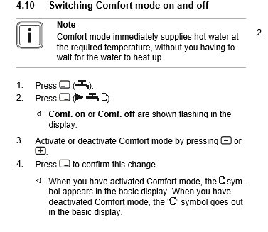

If it's the digital display with 4 buttons, press the top left one twice (once to wake it up) then iirc it will display if comfort mode is on denoted by a C, it might display text asking comfort mode on? Then it's the bottom right button and then top right to confirm.

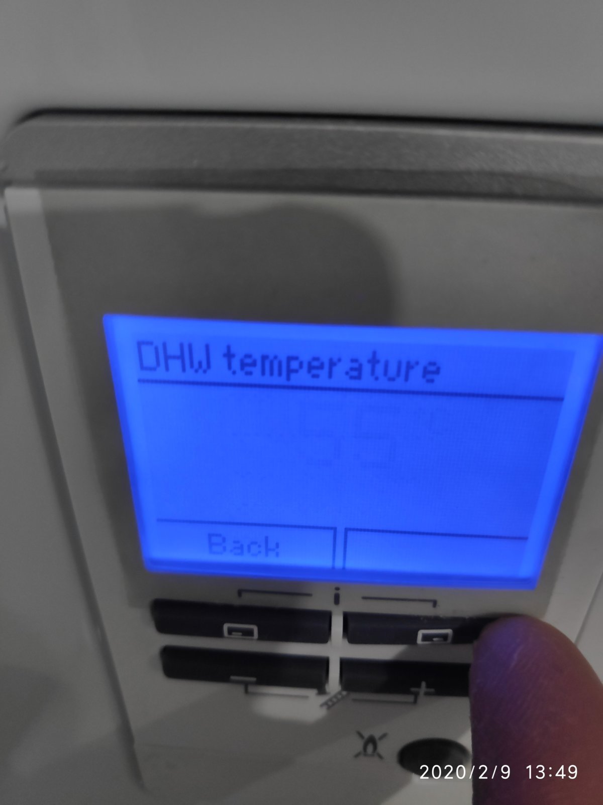

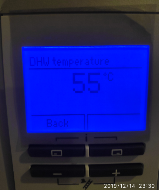

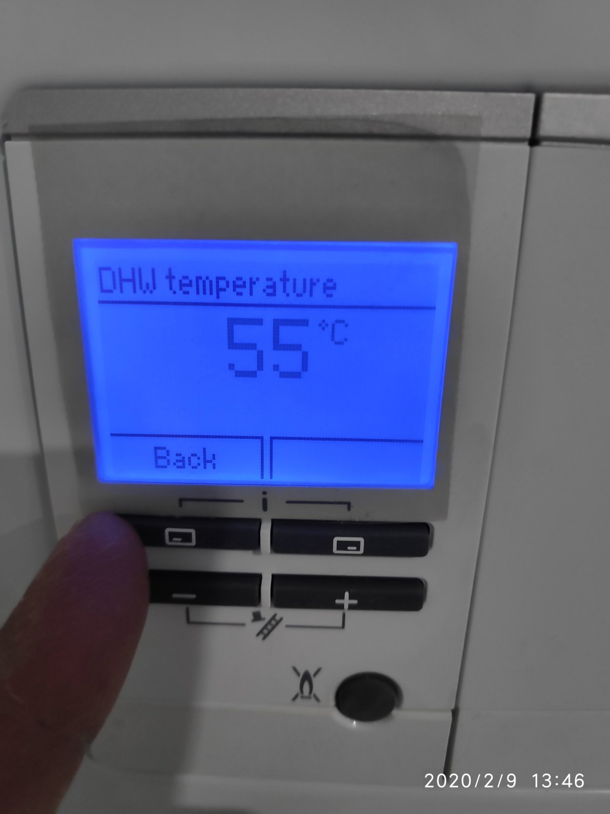

I tried to turn it all the way up and then down but it made no difference. My boiler does have 4 buttons and I tired the top left twice and it took me to the temp setting. I did not see a C or have any other option. This is all I see.

So I've tried what The Novice suggested from the manual and even looked at YouTube vids going through the process on turning comfort mode on and off, but I do not get any options for comfort mode. I'm going mad :mad:.

I'm sure I'm doing it right. I press the first button with the line in the bottom left-hand corner then the button with the line in the bottom right-hand corner, but nothing happen. The temperature just flashes. There are no options.
