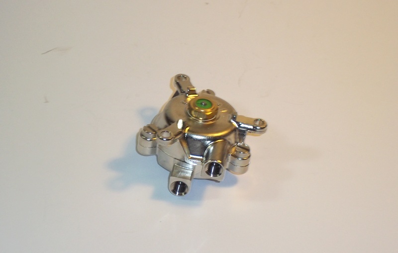

Is this one?
No, that is a differential pressure valve. The wax capsule is called a thermostatic element.
