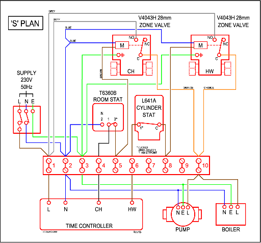

If you have a S plan, like below, you can see where all the orange (switched) wires are marshalled together, shown here in terminal 10 but may not be numbered in yours. Just follow any one orange wire from any valve back to where they are marshalled, isloate the power,remove them all, switch the power back on and see does the boiler stay off, if you can use a m.meter or even a phase tester, you can do the initial testing by checking for 230V at where they are marshalled (with power on but HW&CH programmed off), if you still have power there you can remove them one by one to check individually, orange to N (or earth).
