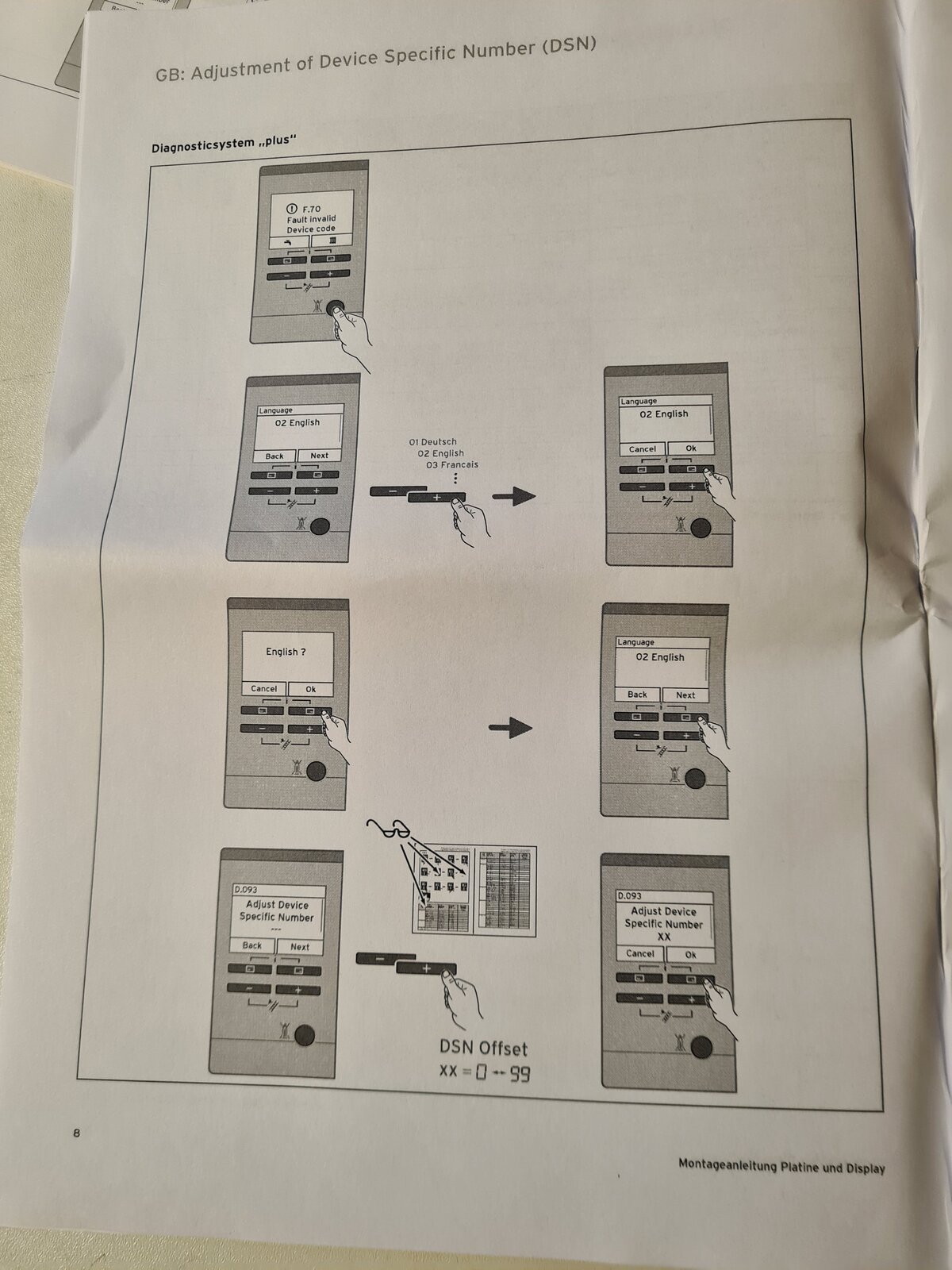

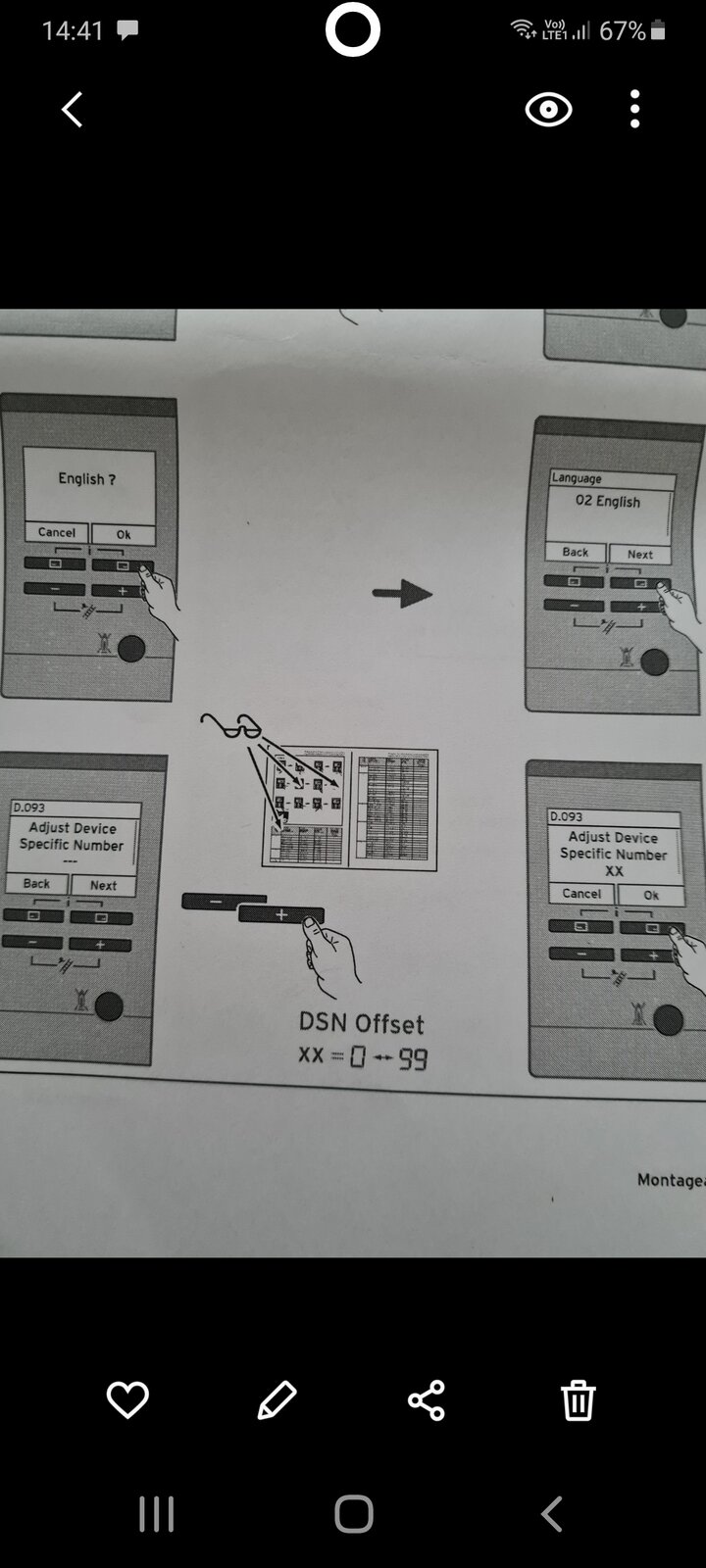

Changed pcb board...getting f7 invalid device specific number....cant get to the d.093 screen to chsnge it...any ideas why...? I get to the last two instruction but after entering language to English it doesn't display the d.093 screen..

Can you take a screen shot of the instructions or provide a link ?
Its this one 831 eco tech plus 2..now it should automatically adjust the parameters cos I only changed the main pcb. The coding resistor is installed from the old board....strange it doesn't display the screen to change DSN..

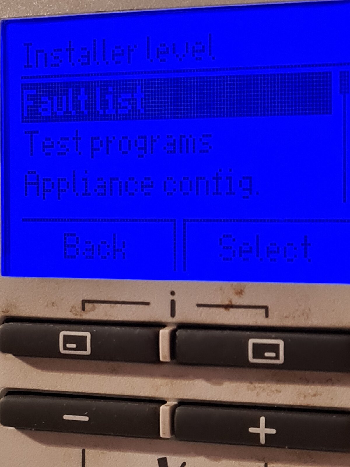

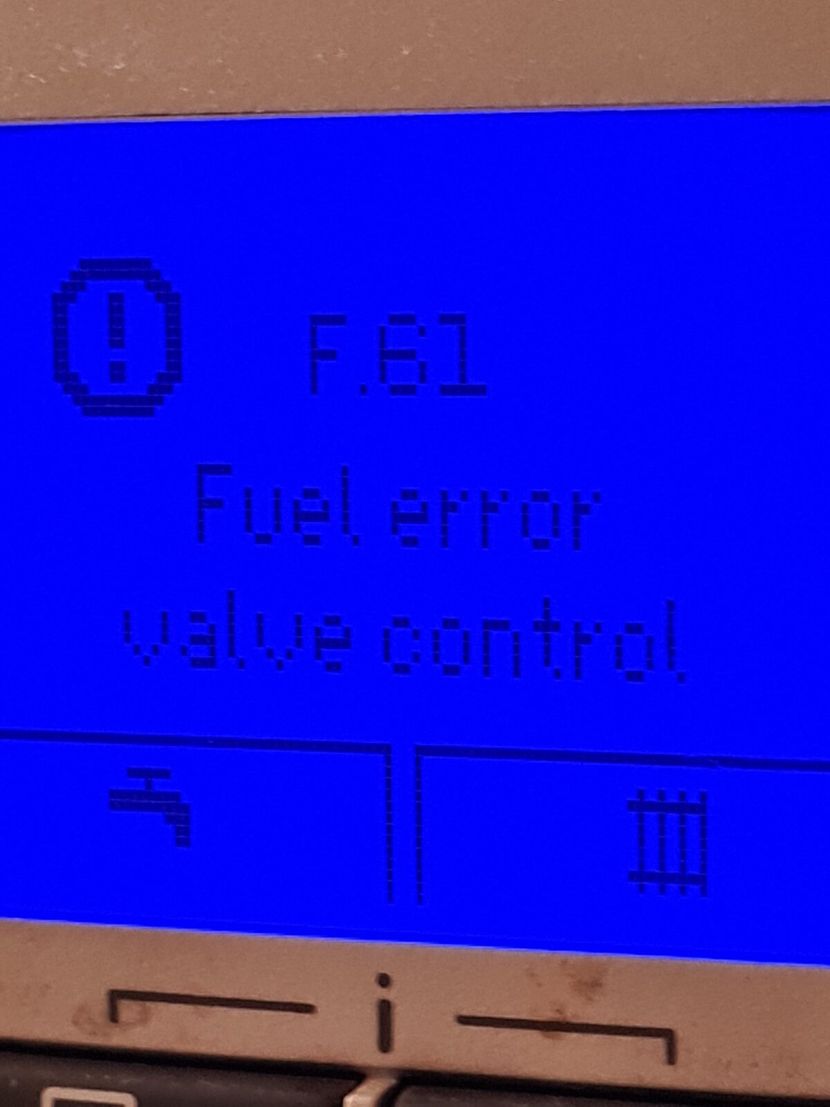

I'm afraid so...wasn't very had to change pcb board....anyway I managed to change dsn but boilers locked me out get this now..
