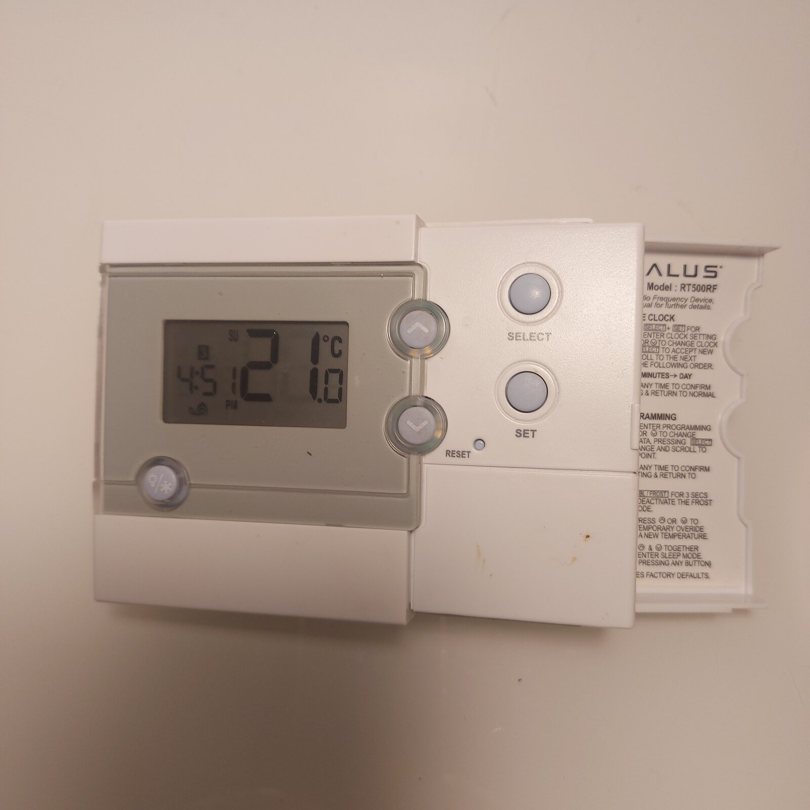

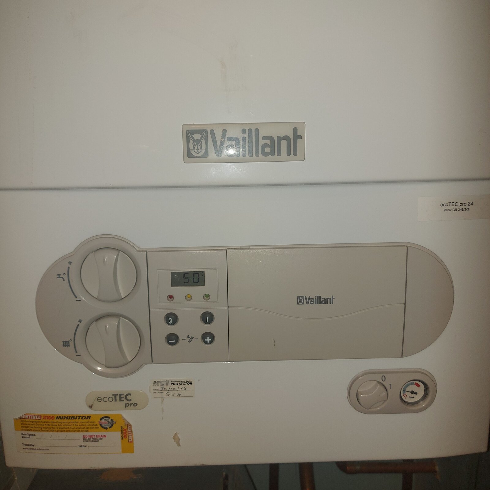

Hi,
I have a Valiant Eco Tec Pro boiler that was installed some years ago.
I currently have an issue with Central Heating not turning on.
When I press the i button, getting s.30 code (room thermostat is blocking heating mode).
The timer is set correctly, has new batteries and no obstruction is affecting the signal.
The lights on the receiver are solid red and solid green. When I reset the timer / receiver, I saw the green light come on and heard a click so I believe they are talking to each other but the boiler does not act.
It's not a water pressure issue.
The Hot Water works.
The override button does not work.
If I press the plus and minus buttons together the boiler does fire up for 10 minutes which does heat the radiators.
Please can you help?
I did not mention that the little flame symbol is flashing as it should on the timer when the boiler timer is set to be on.

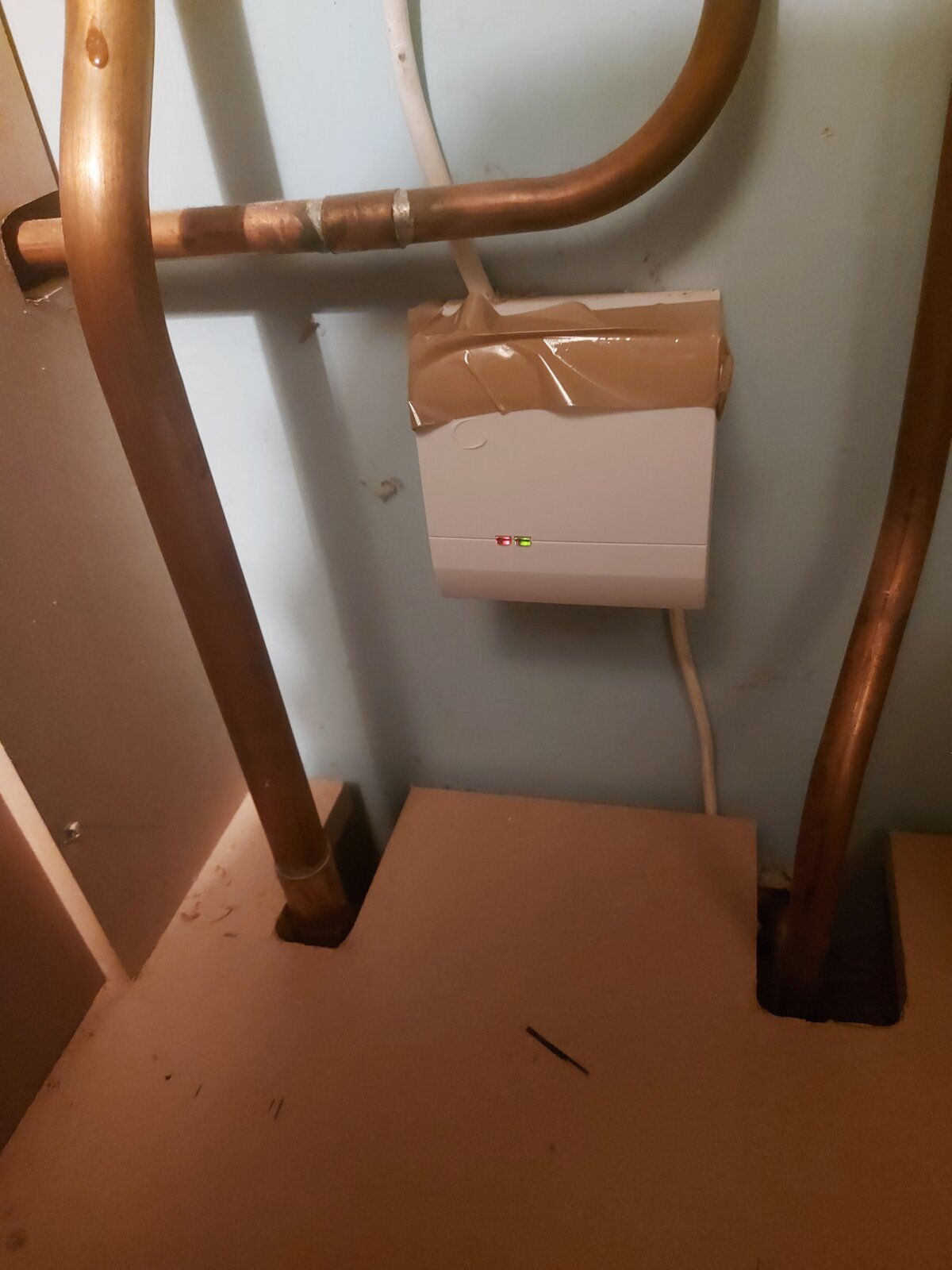

Could be receiver or could be pcb. Post photos of receiver and front of boiler please. It’s also Vaillant, not a Valiant.
Spelling mistake noted.
There is nothing under the parcel tape and the issue was prior to the tape being put there (I was a bit heavy handed).

Try turning the heating knob up on the front of the boiler. If no joy and you want the heating in then you may have to join the 2 wires up in the receiver.
The heating knob was on 54 so have turned this up to 64 but still no joy.
When you say join the 2 wires up to get the heating on. If I turn the power off and open the receiver is it obvious re. the 2 wires and by doing this am I bypassing the timer so becomes a manual set-up?
Do I need new parts to go back to having the boiler on a timer?

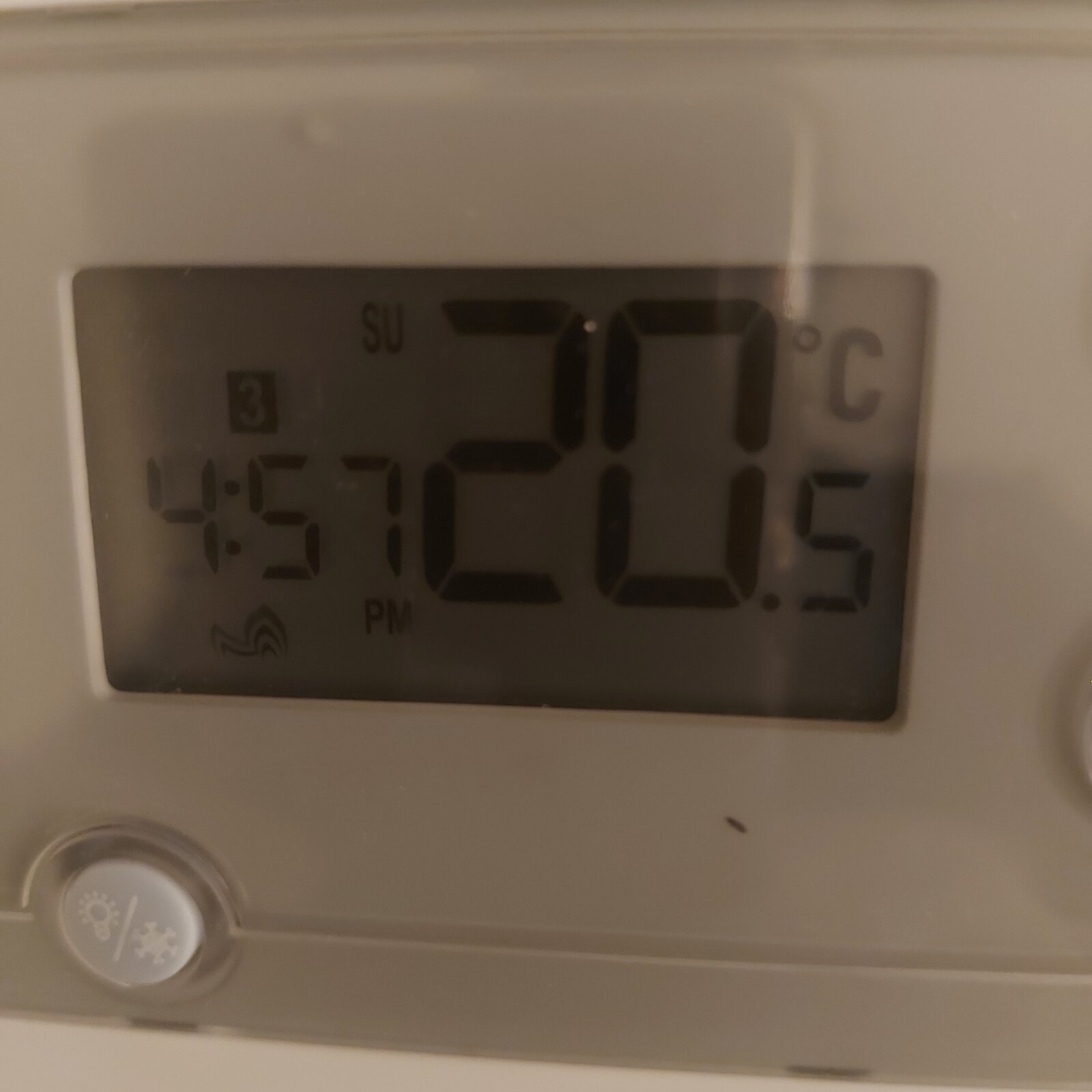

You need to follow the instructions on the programmer to sync it to the receiver.
Because these take a significant current from the battery when they switch you must use alkaline batteries, ideally Duracell.
Cheap zinc carbon batteries often do not work at all or only for a short time.

Thank you EVERYONE for your time, it really is appreciated.
Agile, Im over the moon, you have solved my problem and I wish I could buy you a drink (if that's your thing).
I had brand new batteries in the timer and they are Alkaline. This removed the low battery symbol so I thought all was well. However, these batteries were bought in a discount shop and are not a well known brand so on your advice I have just changed them for a couple of Energizer MAX batteries that I had at home and boom, boiler is reacting to the timer to turn on and off when required (tested 3 times).
Thank you so much.
Glad u got it sorted, just to say decent alkaline batteries will last about 2 years, i replaced my device with new batteries back in april, enrgizer brand.
I nearly mentioned the batteries, but thought it couldn’t be as OP said it was connecting.
I agree CBW. I don't quite understand it as with the cheap batteries, a signal was definitely reaching the receiver. When I did a reset on more than one occasion, I was sitting next to it at when the timer kicked in, I watched the green light come on and also heard a click at same time in the receiver box but it wasn't enough to switch the boiler on. The better batteries has sorted it and am pretty sure if I reverted to the cheap batteries I would be back to having the problem.
Thank you for your time anyway.
