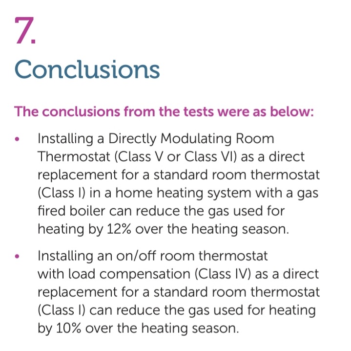

I may be wrong, but I think that is slightly overstated.
There has been research suggesting that good modulating thermostats could improve heating efficiency by up to 15% - though typically 12% - really good.
However, a very good smart stat with proportional on/off load compensation, can improve efficiency by up to 10%.
This can be achieved by local weather compensation, or in the case of the Tado, Nest etc. by internet based forecasting (not as good as local sensor readings, but still adds to efficiency gains).
The difference in efficiency may not be as great as you think?

Yes, it might have been "night v day" between a "basic on/off control" and modulating controls.
But we're not talking about a basic on/off control - were talking about a smart stat with proportional on/off load compensation, using algorithms that estimate the correct amount of heat required for the house to reach temperature, depending on internet and userbase weather forecasting.
The research points to it making a bit of a difference...
So, you're saying it's on/off. That's all it can do, don't you see the major difference, between on/off, and a system which can request say a 10% level of burn from the boiler?
I'm saying read the research....
