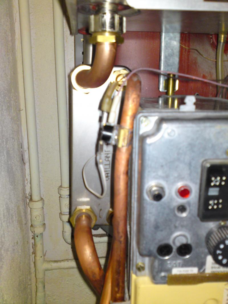

I have a vaillant VCW GB240H combi boiler which has the usual fault with the plastic DHW heat exchanger (leaking).
I have the conversion kit to install my problem is that i purchaced this kit about 2 years ago but never got around to installing it as the leak has never got any worse and i have lost the fitting instructions.
I am okay with all the pipe connections as this looks like they will only fit one way, but i seem to remember something has to be done to the diverter valve and circut board but what ?
Also i have a replacement water section to fit at the same time and i was wondering if anybody can tell me what to do with the copper microbore pipe which i think goes to the expansion vessel as there is no connection for this on the newer version of water section (do i blank it off or leave it open)

Its a while since I did one but as I recall there is a spare pipe which you can often just leave off.
If it does go to the mini PV as you say and you are concerned then theres nothing to stop you adding one to the Cold Water pipework close to the boiler after any check valve. They are available from BES Ltd online.
Generally you are advised to fit one if theres a check valve , water meter or shower in your cold /hot water pipework.[/code]
don't worry about the mini ev. Its been designed out.
I might have some pics somewhere to help you out. Its quite an easy job tbh.
edit..here you are. This might be of some help...
