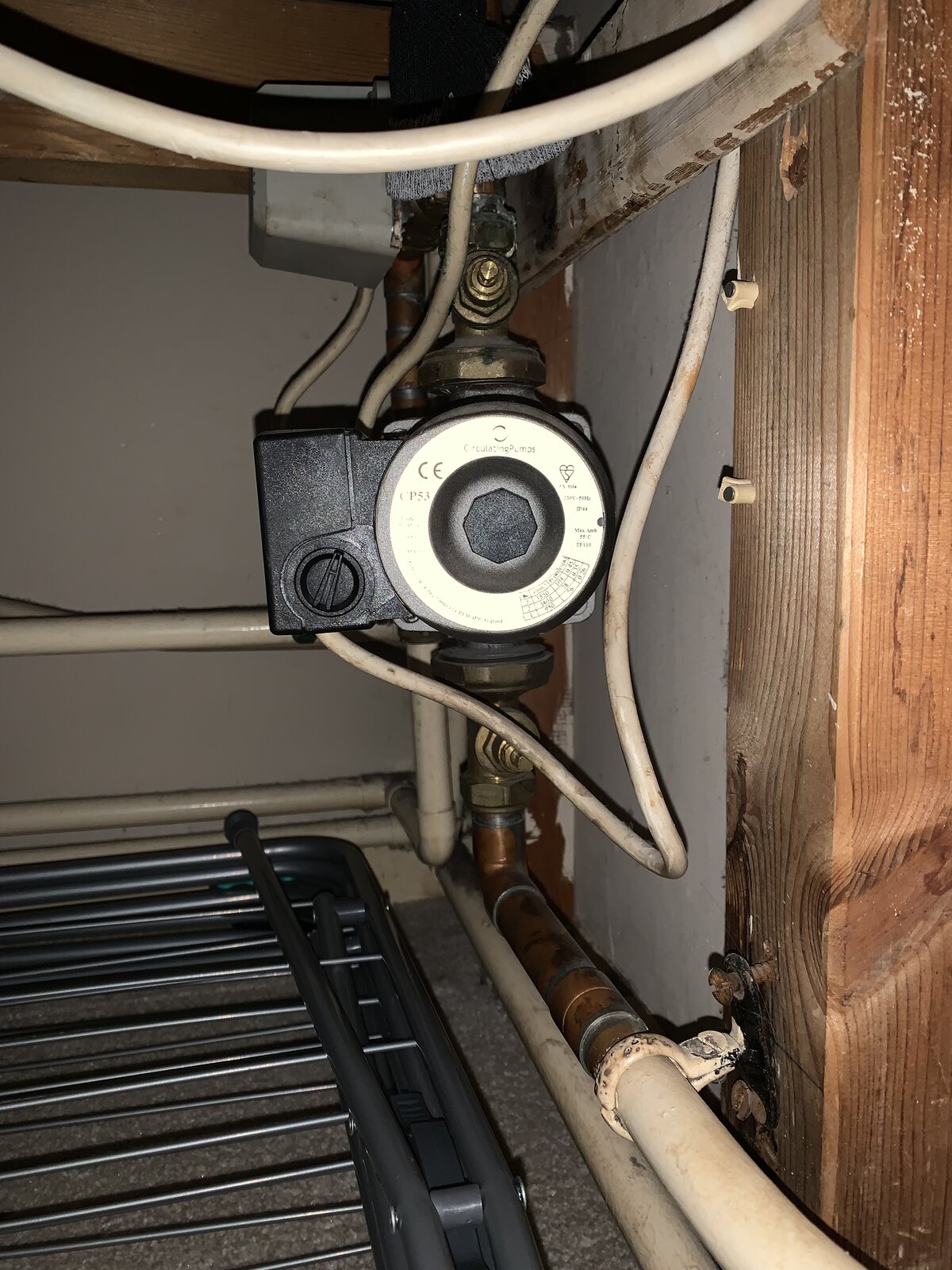

Sorry I meant the pump not the fan, my bad! I have found the pump, attached in picture

The black Hexagonal shape in the centre of the pump can be unscrewed ,anticlockwise, to bleed air from the pump and ensure it is full of water ,have a towel below to catch any trickle of water that comes out from around it.
if you turn on central heating ,does the boiler fire up for a while and then cut out showing the fault code ?

Just feeling the pump to unscrew the bolt, it feels boiling hot, is this how it should feel?
That can depend on flow temperature, but shouldn’t be too hot. What are the pipes like after the pump?
The gold pipe above the pump is boiling hot, beneath it is cold
Sounds like pump failure, or the motorised valve isn’t opening to send the water,but I’d expect both sides of the pump to be hot for that.
So water is not circulating through the pump. The pump is being heated by the electrical current passing through the motor.
