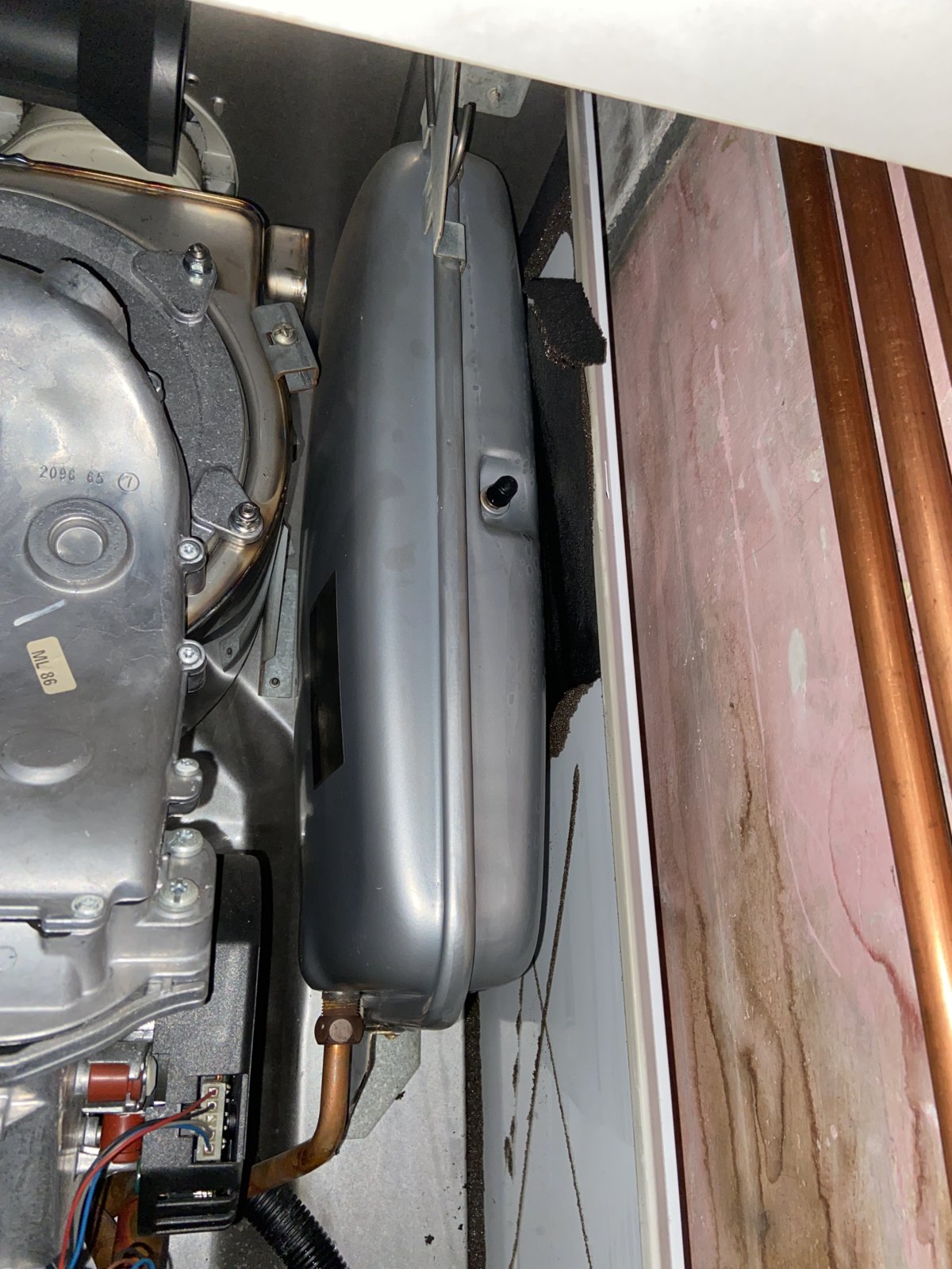

My Vaillant Ecomax has a problem
First of all about a month ago i noticed a few drops from the base of the boiler and a loss of pressure.
After refilling the pressure a few times it seemed to work fine. On thursday the boiler lost power, and today i opened the boiler up to see that there is in fact a huge leak that spills out once i add some water into the tank.
I'm trying to see where this leak is coming from and it appears to come from the top of the tank.
So i have 2 problems, a leak and no power to my boiler. Have i fried the boiler by accident?

Post a pic of what you are calling the tank
Hi Ian - the grey tank? on the right side here, just drops and pours water down its side. i just cant seem to find its source.

The grey tank is the expansion vessel(EV)
Your first post said that you " added water to the tank". What did you mean ?
The EV has a black cap on the top ,like you have on a car tyre ,to pump air into.
Is water coming from the black cap ?

If you’ve e no prior experience with a multimeter, I wouldn’t recommend this as a starting point. You could change the fuse in the plug/spur? I feel this fails, then it’s likely going to be a frazzled pcb. The water on that tank will be possible from a split seam which may need a new vessel, @ianmcd will be better on that advice though.

ah , when i say added i mean i re pressurised the tank using the black levers under the ecomax. The most basic way to refill the guage.
Water might be comign from that black cap , yes.

Unscrew the cap on the EV ,and see if any water there.

Just has someone round, Turns out the expansion vessel has split. So thanks guys, when i found that out i was already aware of what component it was.
Still not sure why it won't power up, pcb board i expect. The fuse on the plug to the boiler is all good.
