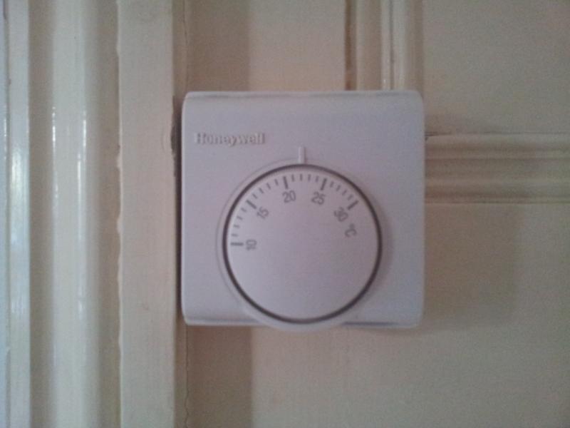

The type of the boiler is the regular one, no extra programmer on it. The separate thermostat to adjust the temperature is a Honeywell model.
Please check the photos attached.
You still haven't posted a picture of your programmer (timer)...

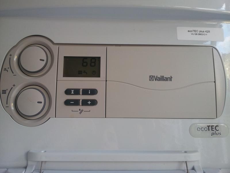

There is no other programmer (timer). I assumed that I could regulate the operating times from the main board on the boiler as shown in the picture. If this is not the case how the boiler is programmed to work only specific hours every day? Is there any other configuration I can make with the existing equipment?
Thank you
If that's really all you have then there is no way of controlling the time when your heating comes on, just the temperature with your thermostat
When is not working the "Heating mode" icon (radiator) is flashing which according to the manual means - Anti cycling mode active. The flame icon does not appear at all. And if I check the information button (i) to display the status of the boiler, sometimes shows the code S.7 - Pump overrun.
During the operating hours after 5pm the "Heating mode" icon (radiator) is illuminated (stable) which means -Heating mode. And the flame icon appears.
There is a note in the manual that may has to do with the flashing heating mode on the screen while is not working.

Not sure how your system is time controlled. The 140 plugin is the recommended timer for your system but that plugs straight into the electronics facia on the front of your boiler - In place of the panel that currently says vaillant on it.
There must be anther remote controller somewhere or a time clock that controls the power to the boiler.

No. You will have a programmer somewhere. Have a good look around the airing cupboard
U must hav a programmer external somewhere, it's not within the boiler. Unless of course u only have that roomstat to control it? Turn it up to 30 an see if it ever goes off. This will tell u if there is a timer hidden somewhere
