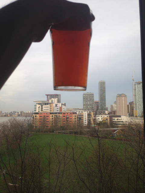

The flue has been fixed today. there was an elbow shaped turn in the flue where 2 longer pipes were joined by a curved piece. That join is where the leak was. there was a black colour rubber ring inside which appeared slightly battered in a small portion. installer has replaced that join and extended the join to elongate the curve. He reckoned there was too much pressure on the single joint that existed earlier.
He insisted on doing a 'flush' (not power) today if i was going to pay him 20 for the inhibitor!! Once flue was fixed I asked him to leave.
However he took the water out and I collected it in a glass and let it settle for about 30 minutes. when i put it against light, the water is Tea colored. I don't see any mud or sludge at the bottom of the glass. Attaching a picture here. Also, I checked all 7 radiators today. they are warm across the surface area. there are no cold spots that i could feel.
Thoughts?
