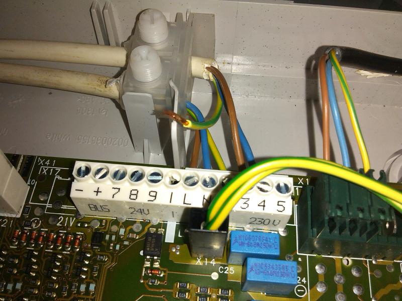

Hi I'm having problems with my Vaillant Ecotec pro 24 boiler where the hot water works fine but the central heating doesn't come on.
It hasn't been used in quite some time and when fired up the heating just won't come on, I had a radiator taken off the wall and put back on when some work was done on the wall so I bled it and the heating did seem to come on for a short while but went off again, and no matter what I try it won't work.
It used to have a crappy salus wireless thermostat so that was turned off awhile ago and I replaced it with a Timeswitch 140 which definitely used to work, I've tried to get the heating on with that in and the heating set to constant, and also tried taking it out completely, I get the same S.30 code.
I've read up about checking pin 4 for power, I assume that's on the pcb and the cover has been be opened like in the picture I've taken? I'm not the best with a multi meter but have set it to 600 and tried to check for 240v on pin 4, but it's a neutral wire so I was confused that it would even have 240v going through it? I put one connector on pin 4, and then the other on one of the live pins like pin 3 if that's correct? I get about 220v when doing that.
There is an earth wire just loose and pin 5 has no wire going to it, is that correct?
To link pins 3 and 4 together should I leave the current power wires going to them in place, and just add a loop wire?

You measure between chassis and the terminal to be tested.
The colour of a wire's insulation has no bearing on the voltage it may be carrying. That is why you need to do measurements.
The loose green wire may be an earth wire and it may not be so until you can see the other end just put a tape round it.
Remove the two wires from terminals 3-4 and put a short wire loop between them and see if that brings on the heating.

Yes the loose wire is an earth wire which I'm guessing the installer didn't bother to tape up.
So actually remove the wires going to terminals 3 and 4 then put a loop in, rather than leaving those wires there and then adding a loop as well?
The cover on those boilers forms part of the combustion seal, which an engineer would be qualified to break and remake which is what makes it a big deal, the time it takes and ease of it has no real bearing.
If you know exactly what is going on at the other end of the wires connected to 3 and 4 possibly you could bridge the terminals with the wires in place, but to be safe best remove them first.

To get specific experience you need to be poking about with a multi meter. Knowing what those wires are doing and knowing what they are supposed to be doing are two different things. Remove the wires then bridge.

I'll remove them and bridge 3/4 to see what happens, and yes you're right even if I fixed the boiler I would get the cover checked when I get my radiators fitted shortly
Erm well both myself and tony are heating engineers, so I would have thought that was experience enough tbh.
Sorry I wasn't doubting your abilities in the slightest I just hoped someone who had specific knowledge of my boiler would be able to say yes those wires are definitely needed when a loop is made or no they're not that's all, I would be stuck without your advice so it's very much appreciated!!
disconnect them and make a loop tomorrow and see if it works, thanks for the help both of you :)
Well it's good news, the boiler works when linking 3 and 4 together! So does that just mean the timeswitch I had fitted is faulty? Thanks
