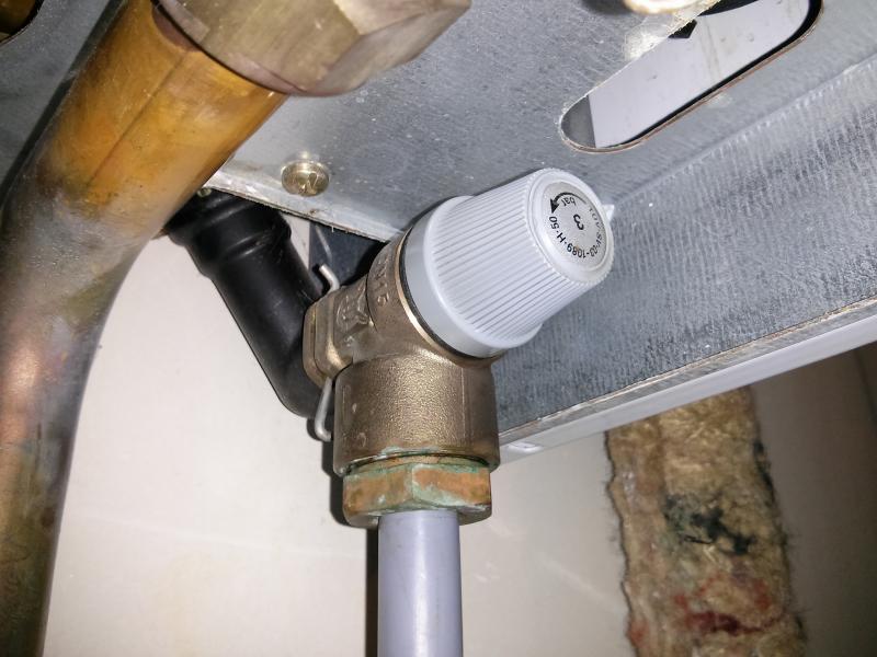

The boiler is in the loft (don't ask!!) and the PRV pipe exits pretty high up so I'd rather not get up there if I can avoid it. I think I'll just replace the PRV if that is easy enough to do. It must have opened far too many times in the past year.
This is the valve:
Pretty sure it looks like it is Vaillant #190732 (boiler is thermoCompact 637E)
There are quite a few on ebay although not entirely sure if I'd trust that. Can be found on other more reputable sites - open to recommendations if that's allowed on these boards.
http://www.ebay.co.uk/itm/VAILLANT-PRESSURE-RELIEF-VALVE-190732-/290996404008
http://www.ebay.co.uk/itm/Vaillant-...ressure-Relief-Valve-PRV-190732-/330671680029
http://www.gas-spares.co.uk/Catalog...-Aquaplus/PRESSURE-RELEIF-VALVE-3bar-Cw-elbow
Is this fairly straight forward to replace?

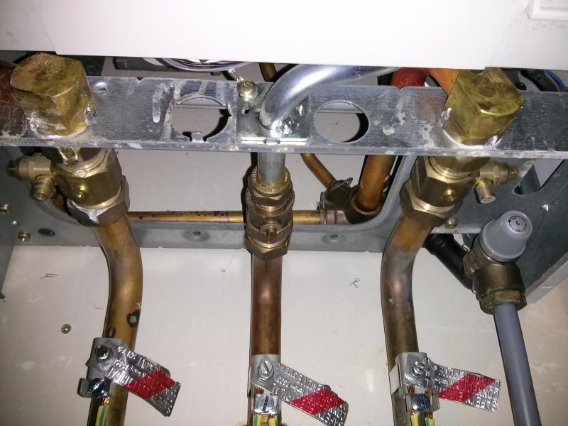

Found a similar question on another forum. This is my surmising of what was said:
- Release system pressure
- Turn boiler off / isolate electrics
- Isolate valves on boiler (left and right pipe turn valve half turn - middle pipe is gas)
- Unscrew bottom of PRV
- Remove the clip on the elbow (I think it's called that)
- Unscrew valve anti-clockwise (have bucket ready)
- Silicon grease on the threads?
- Screw on new valve
- Replace clip
