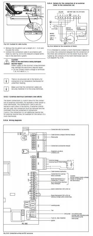

Hi,
So I have opted to get a Nest.
I could do with some guidance on how to connect the Heatlink to the boiler.
Obviously I can't use the Ebus as Nest do not support Ebus. So I believe I need to use connector 3,4 & 5 on the boiler.
Based on reports of awful install's of Nest's by 1 of there appointed UK subcontractors I would like to tackle this myself. Am fully aware of the need to switch the power off first.
My system is not zoned.
Below are the Nest & Vaillant wiring diagrams.
Any advice appreciated.

Doesnt look like the nest is any different to wire than just about 99% of all clocks/thermostats looking at that diagram
