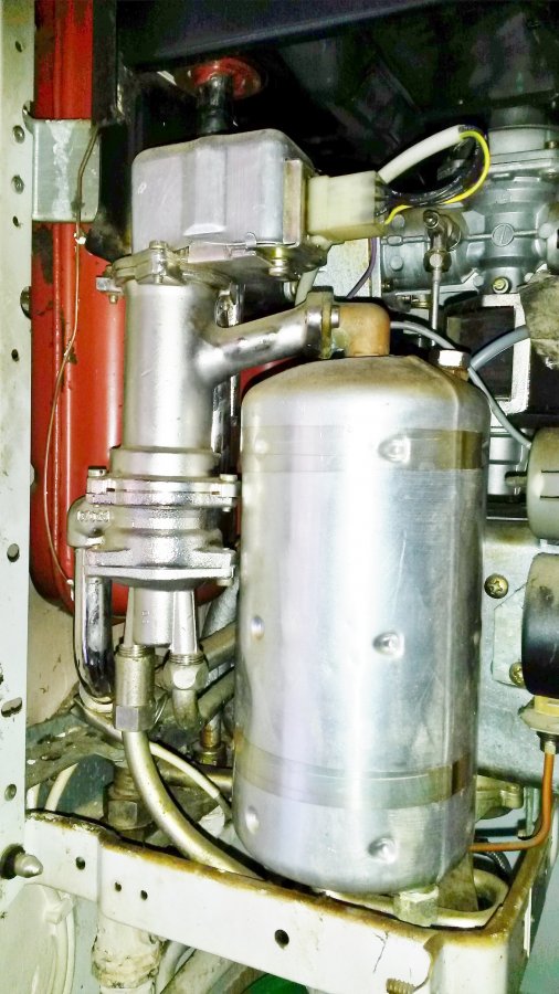

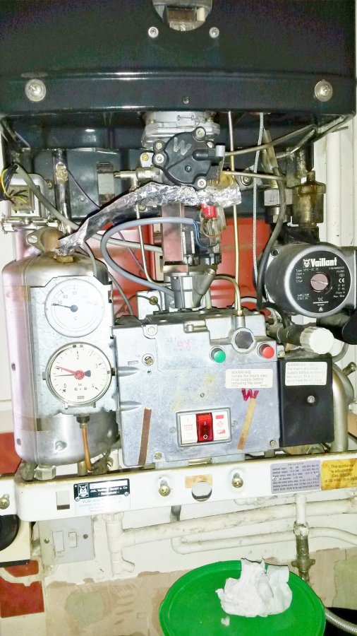

Hello guys.
I use Vaillant sine t3w combi boiler and the will not fire up when a tap is opened nor does the Central heating work. Any experts in here . I have attached pics.

Does it have power going to it? You need a multimeter and the skills to use it if you're even going to begin to diagnose this yourself

How do I check if it has power going to it? It does switch on and ignite. Whenever i turn on the hot water tap i can here some clicks going on inside the boiler.
If you reach in to the right hand side towards the back of the square box there will be a small rubber "tit" press that if it clicks and the boiler fires you just got lucky, anything else & you will need an oldr engineer

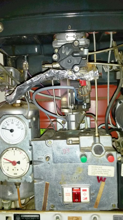

Hello algas. Which square box? could you please point that out from the pics I posted. Thank you
Hello Algas. I did find that black rubber tit. I pressed it while it was off and also pressed it while it was on.Is there a right way to do that?

Duncan, when you pressed the "tit" it would have sort of clicked, I think you need to find an older engineer as these boilers are repairable if you can get the bits, or know what you are doing, check that the pump isn't seized by undoing the large screw on the front, a container underneath to catch the water then with a smaller screwdriver turn the impeller clockwise, again you may be lucky.
