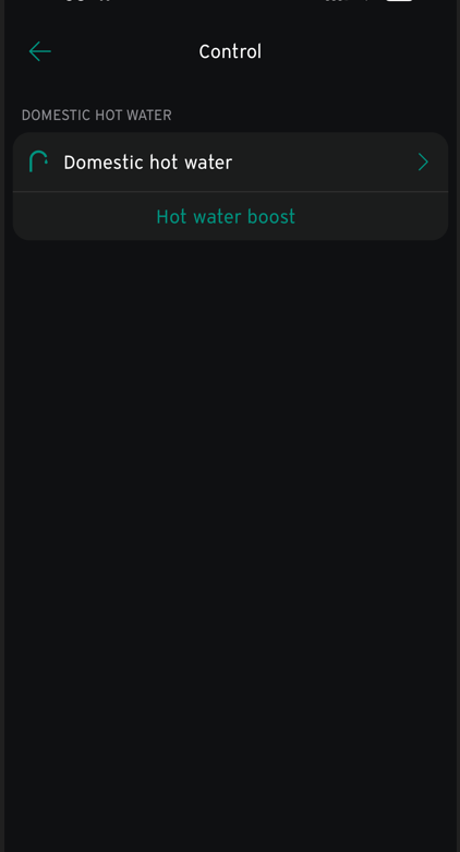

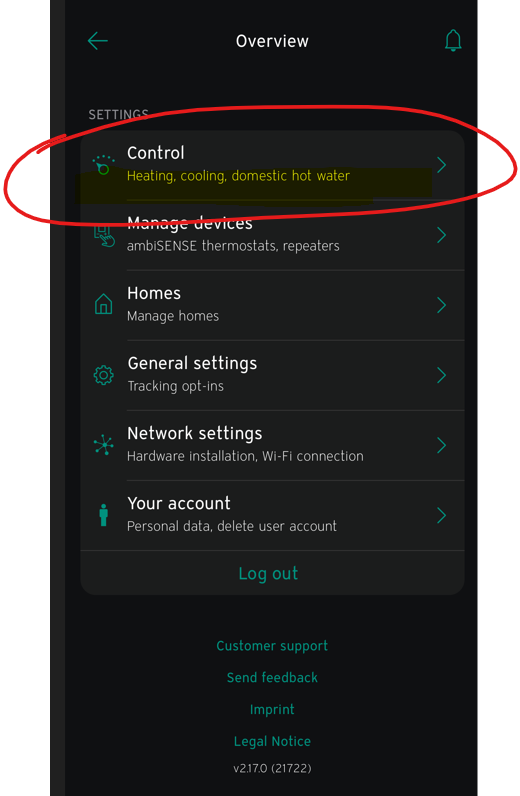

GJones2021 - maybe you could help me? I have 2 x TRVs in Room and 1 in Room 2. In the App, on Overview. the first option is Control, within which the options say Heating, cooling and domestic hot water. But when I select Control, the only option I get is Domestic Hot Water. Are you seeing Heating and Cooling too? (Not sure what Cooling is!). If so, what kind of control does it offer?
I don't know if it relates to more complex set ups but as I'm not currently there I don't want to play around just in case I end up with the heating on 24/7!
Hi SJRSJR - yup, I see exactly the same thing in the MyVaillant app.
I think the layout in the MyVaillant app is very confusing - unlike SensoAPP, there isn't really a Home Screen, so to see any general setting you need to select a zone/room/TRV (in my case because I defined each TRV as a room they are synonymous) and then you get access to general settings such as 'control', network settings' - that seems most odd!
My guess regarding 'control' is that if you had A/C, (or other Vaillant 'exotics' not typically seen in the UK like Forced Air Heat Recovery units it may have more relevance?)
I think you might see 'Heating' and be able to control heating in a situation where there were no TRVs but standard wall stats? I thin the usual UK domestic setup probably has a roomstat upstairs and one downstairs - and only then if there are two zones?
I've also not played with DHW - since I have a combi. I suspect if you have a typical S- or Y- (or X-) plan system then you can override the programmer for the cylinder with a hot waster boost?
