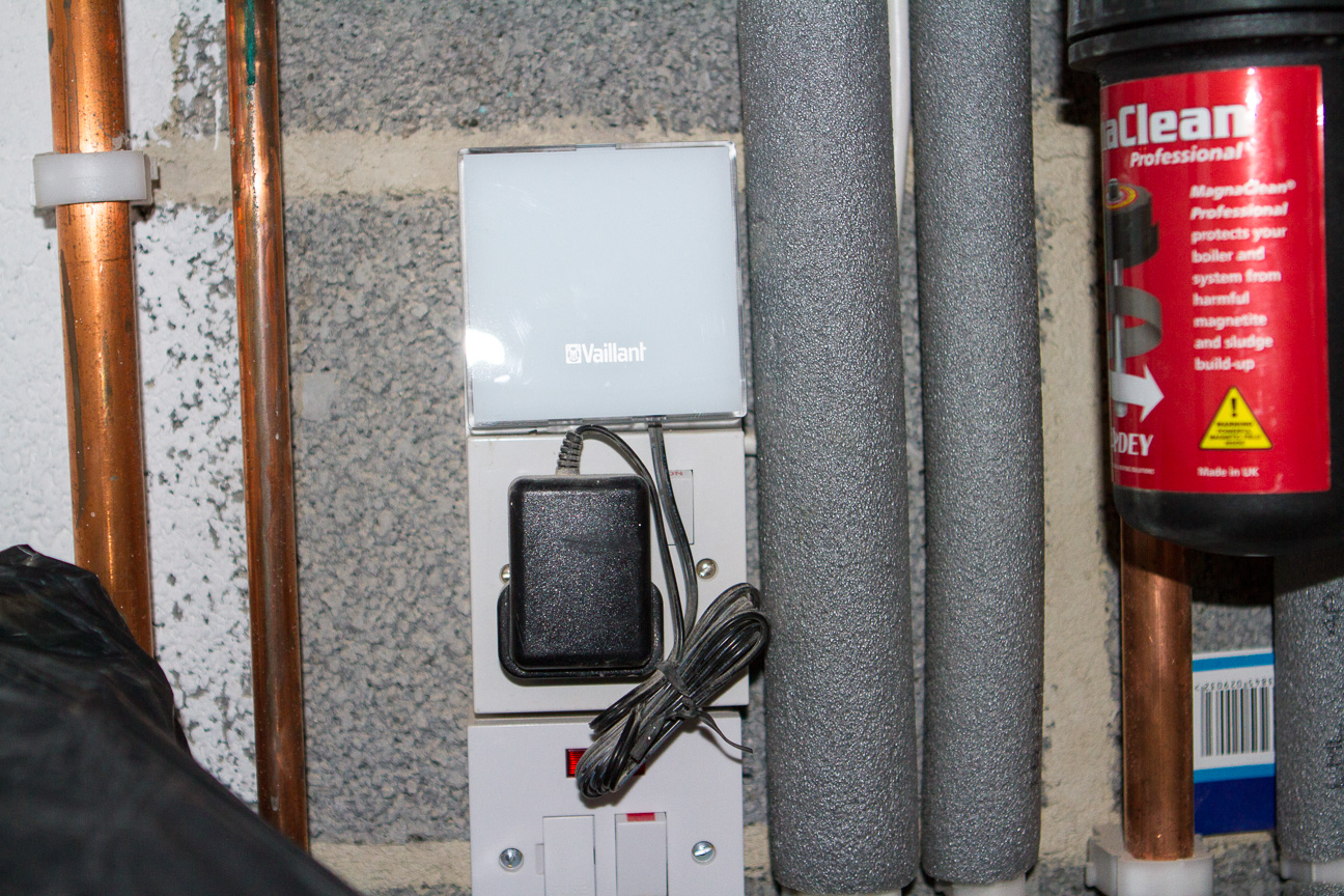

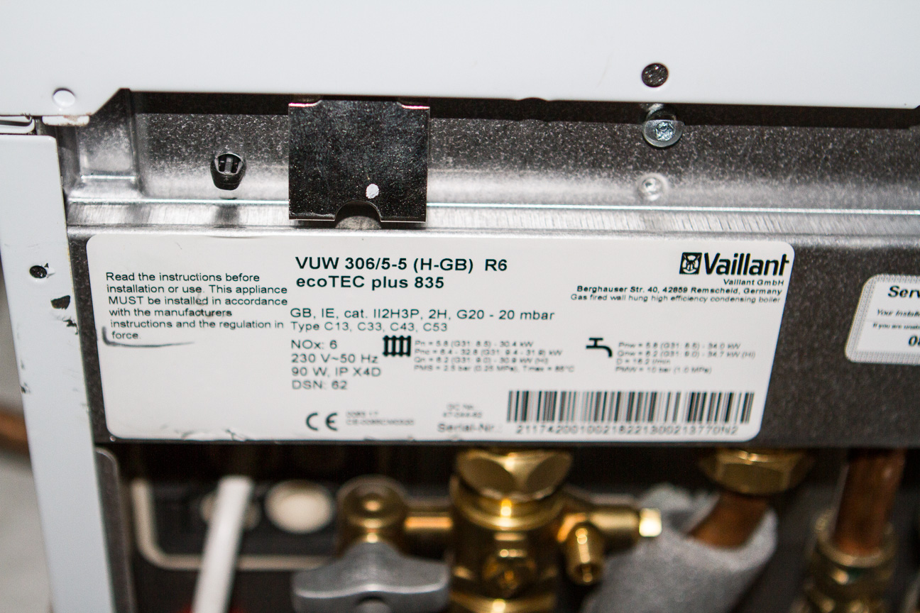

My brother has a Vaillant ecotec plus 835.
It seemingly has weather compensation installed and a smart thermostat, bluetooth control, mobile control etc. Is this called the vsmart thermostat?
Anyway, he has had to call out Vaillant out a number of times due to a fault with the thermostat control that renders it inoperable. Each time they have replaced the whole thermostat control unit. It is as if there is a common and ongoing fault with the thermostat system. No other issues are apparent with the boiler's operation . It is still in warrentee so vaillant are doing this as per that service at no cost.

Here are some images to assist.

I would be keeping the current Vsmart and if it fails again, asking for a Senior engineer to attend, and having them explain whats going on, as theres no ongoing issues with the units I've ever seen, so it may be something else thats causing the problems, first of all being that going by the picture theres almost no way that reciever is sitting properly flush against the wall when its mm's off the socket (they need to be perfectly flush for the connections to make properly at the back) also it would appear to be in a garage at a guess where WIFI signal may be low, relocating the Reciever closer to where the router is may be an option as well, they dont use much bandwith so will creep along with very poor signal for a while then fault (many apps that can check signal strength at different points of the house)
You are certainly correct about the first point.
For some reason....and I know not why....that socket below is powering the receiver via that adapter/transformer. But for the receiver to be connected to the transformer, the cable is very tightly squeezed in behind the connection to the wall. So the cable is causing the receiver to not be attached properly to the wall.
The second point should be less of an issue......it is in an internal utility room and within the envelope of the main house and within the router range.
But that first issue is certainly something to look at. Although I am surprised it has not been picked up by the multiple replacements thus far.

As I said the cable going into it is causing it to be raised off the wall.
Does the cable normally have a route into the receiver that does not cause this?
