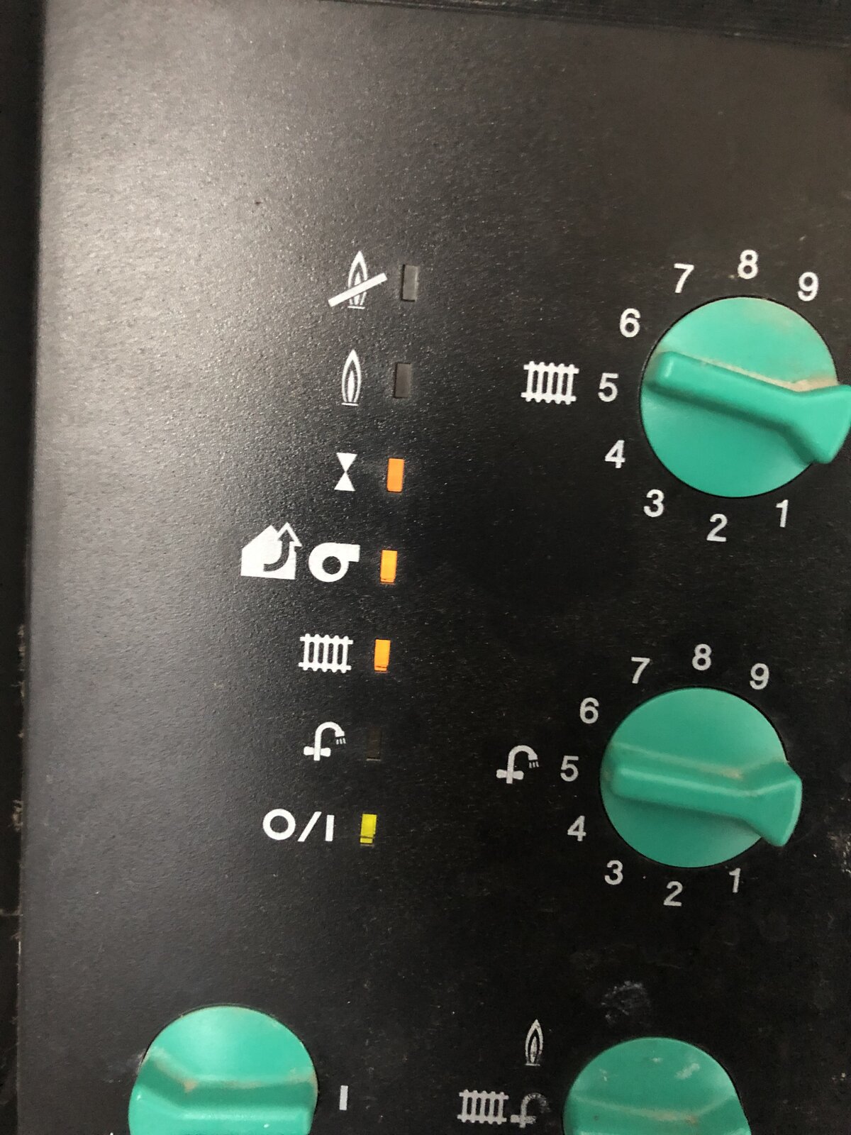

Vaillant TurboMax 282E boiler not firing....
I have installed a digital termostat, in which at first had problems as I later found that someone connected the live to neutral half way down the thermostat cable.... this would mean that the thermostat neutral terminal on the PCB may have been getting live current.
This caused a fuse to blow.... I replaced the fuse, I then fixed that wiring and themostat worked properly and hot water was fine. After 4 hours, the central heating nor hot water would not turn on.
First, the red flame led illuminates, I can heating ticks from the boiler..... then the red light goes , then 'egg timer' symbol lights up amber. See pic attached.
I have tried resetting this, manually igniting and still no joy.
Called a local gas engineer and he said it could be the PCB ( told him the story above) or Gas valve.
So I changed the PCB and still the same thing!

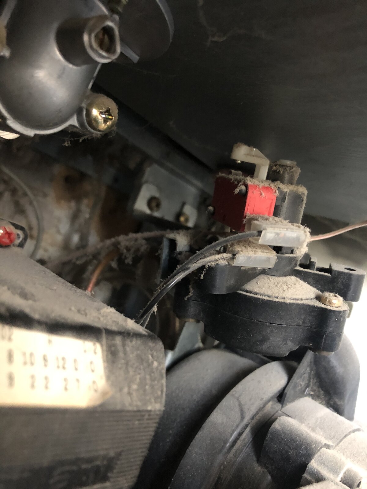

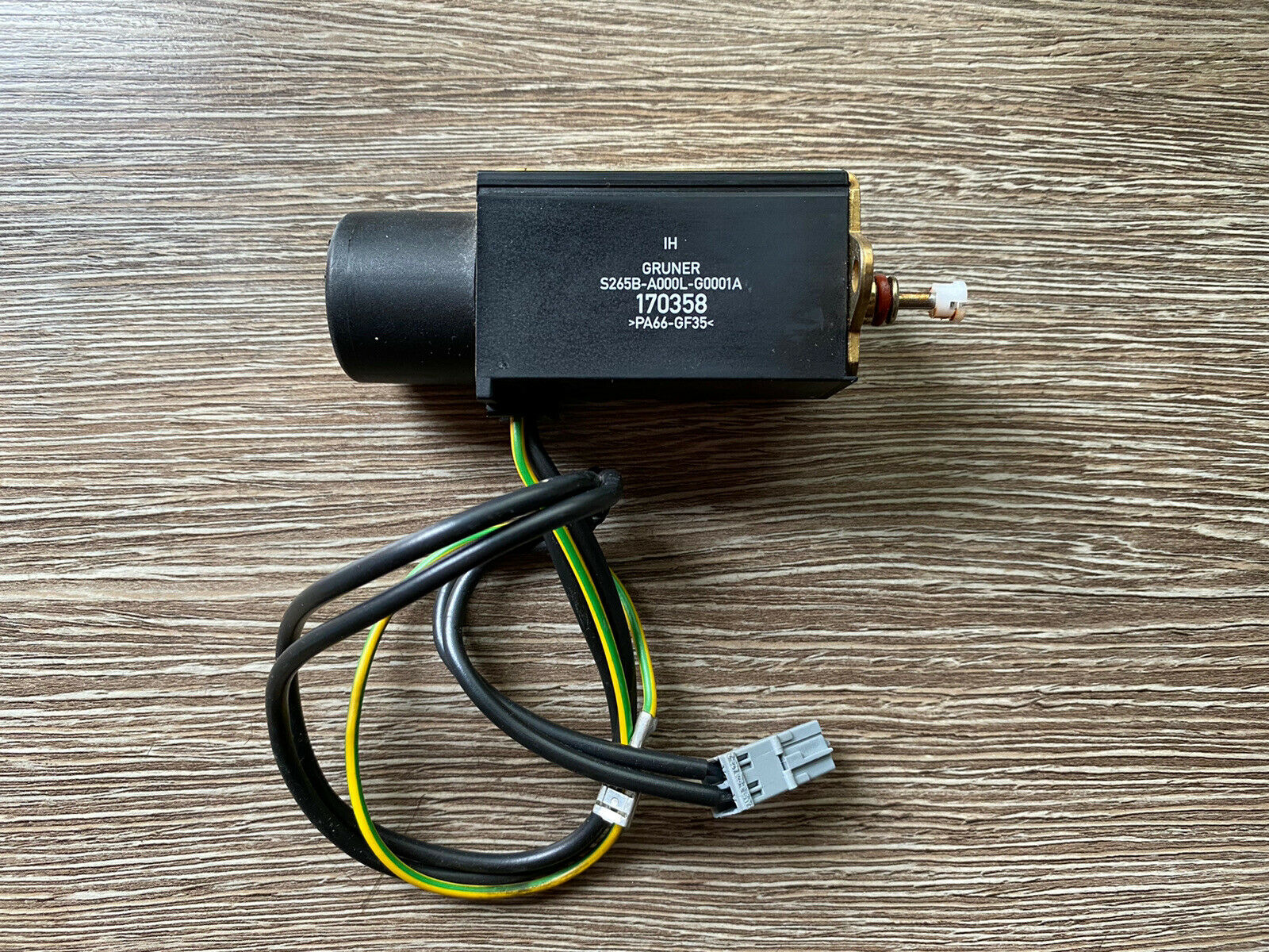

As for the gas valve, maybe the GAS VALVE MAGNETO needs replacing? or the whole part... as from above, seems like maybe the electric part of the gas valve maybe faulty...
Can this little part be easily removed, would cause gas leak or is an actuator directly connected to the gas pipe?
