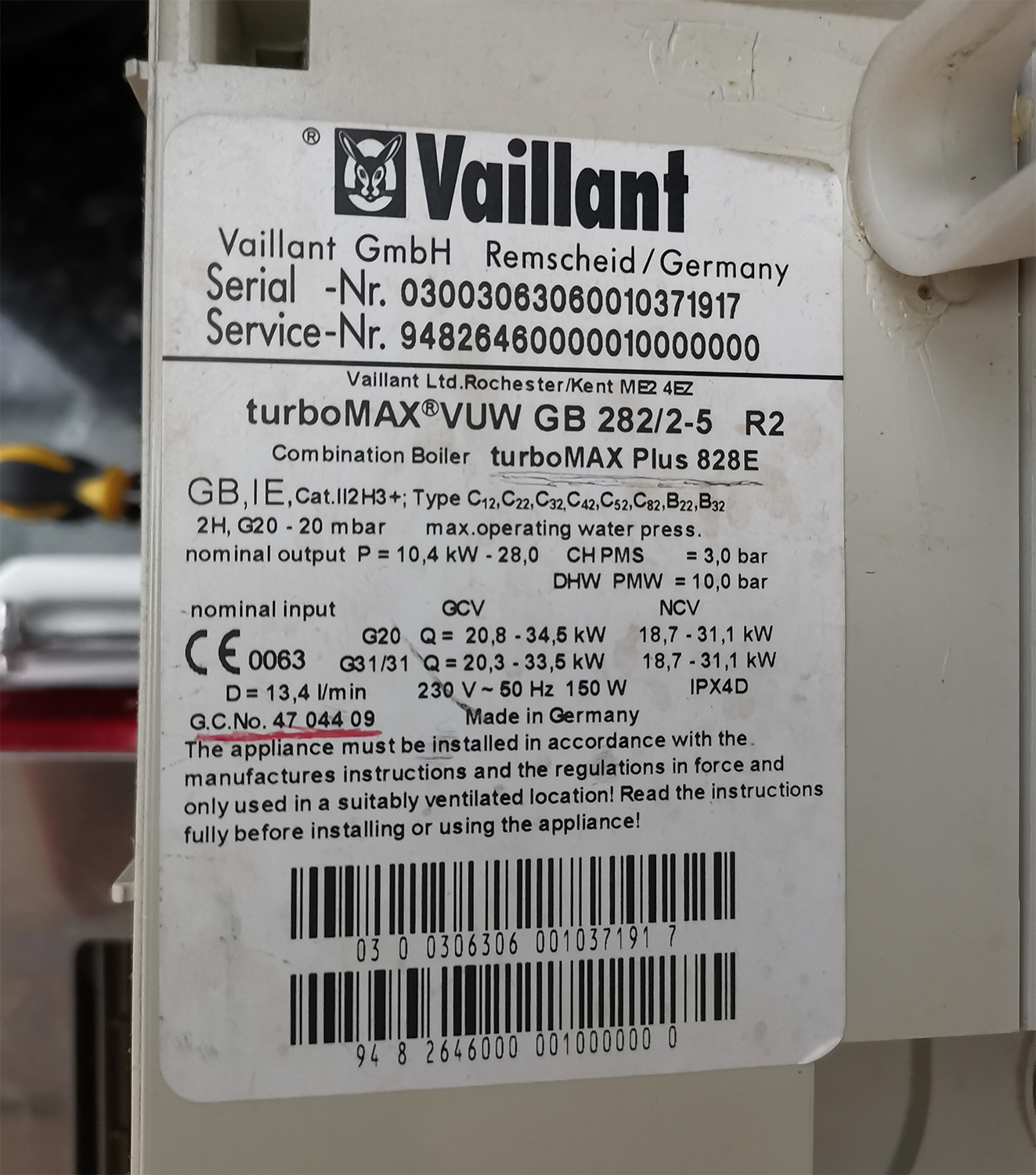

I have a Vaillant TurboMax Plus 828E which I’m experiencing an issue with persistent cycling using the central heating.

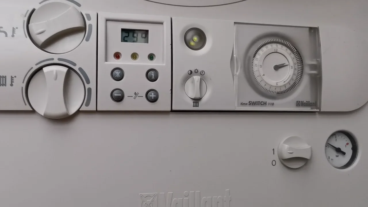

I thought I'd provide a video (with audio) to understand what's going on better.
Boiler has been idle for an hour. Drayton Digistat RF1 set for 20c (17c currently in the house).
Timeline below if you'd rather not watch the whole 20 mins.
0:00 - Ignition fires up, yellow light, flow begins
10:00 - 55c target flow temp reached, ignition cuts out
13:00 - Within this 3 minutes, light fan/pump noise?
16:00 - All quietens for this remaining 3 minutes
16:20 - What sounds like the ignition firing up, maybe me making noise
16:40 - Ignition fires up, yellow light, flow begins again
19:10 - 55c target flow temp reached, ignition cuts out

Thanks for your advice, appreciate your input. I've taken some readings this morning before work, let me know what you think.
Just before it reaches target flow temp of 55c, as it's still burning and just about to cut out.
Reading
d.40
56c
d.41
42c
As target flow temp of 55c has just been reached and ignition has just cut out / yellow light just gone off.
Reading
d.40
45c
d.41
43c
At the end of the 6 minutes cycle time, about 10 seconds before the ignition ticks and boiler fires up again.
Reading
d.40
44c
d.41
44c
A second before the ignition goes off, fires up and yellow light switches on.
Reading
d.40
41c
d.41
41c
The burner shouldn't cut out until SP+5C, (55+5) 60C, with your settings, see below.
That boiler has a minimum output of 10.4kw (at least the 2E has, can't find MIs for the E model) ), Once the heat demand falls below 10.4kw then the flow &return) temp start to rise and when the flow temp reaches SP+5C, 55+5, 60C in your case, then the burner trips, the circ pump continues running and when the anticycle time has elapsed (and as long as the flow temp is SP-5, 50C), then the burner will refire at ~ 60% of the boiler's rated output, so 28*60%, refires at ~ 16.8kw output, if the flow temp on refiring is 41C and the SP is 55C, a dT of 14C, then the circulation flow will have to be 17.2LPM for a boiler output of 16.8kw (for up to 1 minute), its very unlikely IMO that the flowrate is this high, if you can get the flowtemp down to say 35C before refiring, this gives a dT of (55-35), 20C, so "only" requires a flowrate of 12.04LPM, which is far more likely IMO to be your actual rad circulation rate with all the TRVs opened up. I would increase the anticycle time, as suggested, to get the flowtemp down to 35C or less and see how you get on. Also once it does get away after refiring, time the on /off cycle times, that will give a good idea of the actual heat demand.
