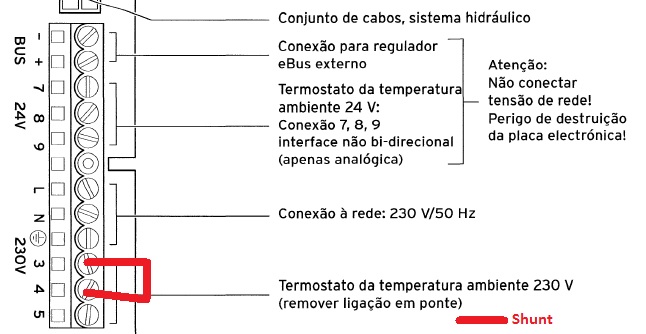

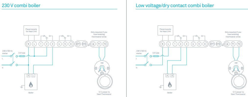

Hello everyone!
I'm planning on buying a Nest for my central heating (no thermostat at the moment)
Just want to make sure I get the wiring right (I'm a newby to boilers)
Right now I have a shunt between 3-4.
With the Nest do I need to use the 230V combi boiler diagram and connect to 3 and 4 (shunt removed)?
or
Low voltage diagram conecting to 7-8 or 8-9?
Do both work?
Thank you
