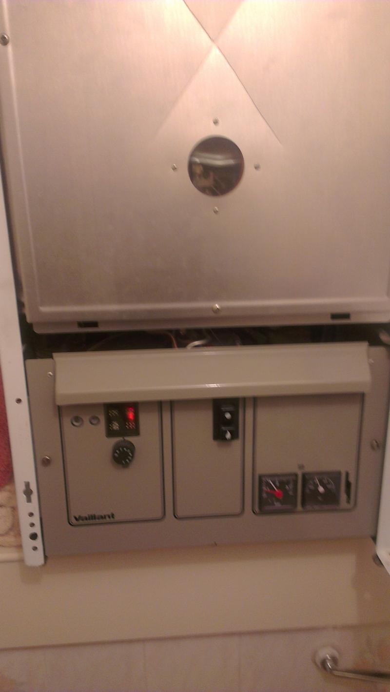

Hi.
I have a Valiant which will not heat the DHW.
With the CH off, turning on a hot tap causes a sorta whirring noise for a second then nothing. No hot water.
With the CH on, turning a tap on provides a small amount of warmish water and then cold. If the Boiler is fired up the act of turning the Hot water tap on kills the boiler. Turning the hot tap off relights the boiler for the CH.
I am not sure of the exact Valiant model but here is a pic if that helps.
Bottom line is can I do anything about it being a Handy kind of Bloke :LOL: or do I need a Gas Safe person to do it for me?
Thanks in advance
Dave
Sounds like a HW NTC fault, call a gas engineer to take a look as an electrical tester would be needed to test this.
If the NTC is recording less than 13,000 - 15,000ohms at room temp then that maybe what is holding the boiler off, given the fact you say you get a tiny bit of heat after the heating is on says to me the diverter valve is functioning.
That's rubbish advice on this model ignore. U have a vcw 221 ceased manufacture 1996. U will need a rgi for this as they r tricky. Unfortunately vaillant won't attend due to age
