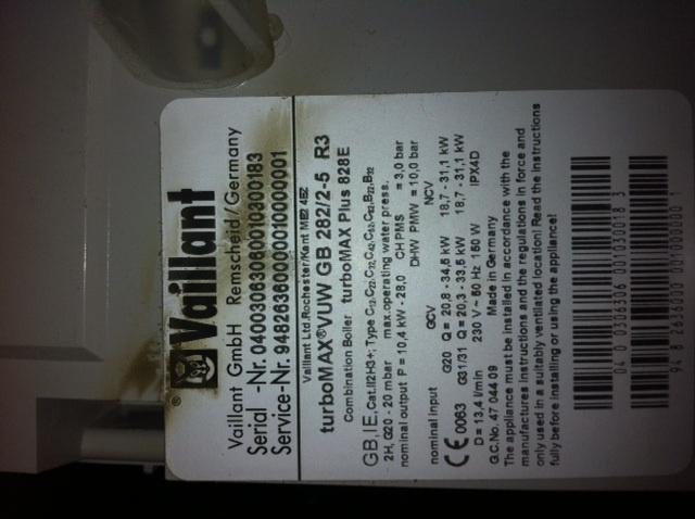

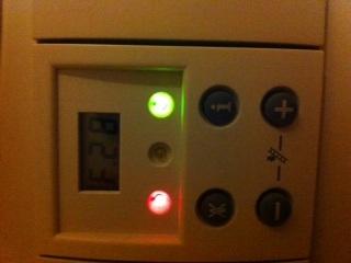

Our boiler is roughly eight years old and has been working fine until now.
It can run perfectly for a day and half and then a red light and Fault code F28 appears,then obviously we press the ignite button and it works fine again until the next time.
It seems to have no pattern,it can work fine for a good while and other times switch off regularly in the same evening.
The water pressure is fine and also the demands of running a hot bath,shower,central heating seems to have no bearing on the fault i.e. I can run a hot bath/shower/whack heating up high and it handles it fine.
I've rung Valiant and they say they would charge £260 for a all in one style fix which means they will get an approved engineer to visit,diagnose and repair.
All parts and labour vat are included in that but it doesn't cover the heat exchanger of expansion vessel.
After speaking to previous residents it sounds like the boiler has never been serviced ever in its life
I've included pics of the serial label inside and of the fault panel.

F28 is Boiler Failed To Start, which could be an ignition fault caused by dirty electrodes, or could be something more sinister like a gas valve or ignition transformer fault
