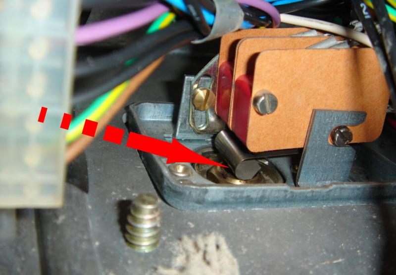

A close 82 year old friend of mine has a valiant vcw sine 18 T3 W and it last night started running continuously. She has had an electrician look at it and he says he has gone as far as his knowledge allows and has checked and disconnected both the programmer and the room stat but the boiler continues to run continuously.
I just wondered if any of you guys on here could suggest any obvious places to look or check, Thank you.
Thanks everyone, I'll go check it out tomorrow. Is it likely to be the pin sticking or the microswitch that needs replacing as I'll just order another if that's the case?
Thanks again for the prompt replies.

Great old boilers , will never see anything like them again, check the stuffing box for signs of leaking, if the pin cruds up it can jam the micro switch in the made position
Many thanks everyone, it was the pin that comes through into the PCB box from the diaphragm (which I replaced last year actually) the pin was stuck in the up position demanding hot water. After checking the microswitches, I freed it up and she runs like a watch again now. Thank you all for your expertise, as well as myself, you helped make on old lady very happy.:)

OK, now to the problem. Do you think it is a microswitch in the base behind the main switches? The heating and hot water work OK, but the heating when turned on with the left-hand switch comes on, and then when the rooms are warm even removing the thermostat the boiler keeps on running as if the thermostat is calling for heat.
The pin and the diaphragm are rising and falling as they should as it is shown in the picture on this thread, and the hot water will turn on and off OK with the heating switched on.
I notice that there are two microswitches. Is one for the heating and one for the domestic hot water? Could one of these be faulty?
