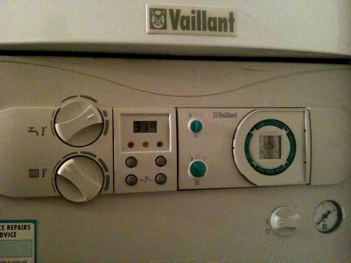

If anyone can identify the boiler model in our rented flat we'd really appreciate it. We had our first go programming+bringing the pressure up to 1.5bars this morning-but when we turned the heating back on the temperature started flying up-we turned it off when it showed 56 degrees. Not sure if it was meant to do this, but the flashing lights didn't quite look right. Trying to find a manual for this boiler-landlord gave us one for the timer, but it doesn't cover the actual boiler, just programming the timer to come on/off. I've upload a photo of our boiler. Please help. It's cold+we're afraid to turn the heating back on!
the model number will be on a label behind the front drop down flap, 2 plastic screws with a cross head on the top corners of the front panel, the pressure gauge looks very low by your picture, boiler mmay have no water in it if the temp is racing up.
We've just checked, and the label doesn't appear to have been filled in. We've brought the pressure up to about 1.75 from 0.5 this morning, would this cause the temperature to shoot up when we turned the heating back on? Should we just let it get on with it?
the label is printed and stuck on by the manufacturer, how does it perform on h/w, have you contacted the landlord about this, they must have a regular installer.
Was the heating working OK before you adjusted the pressure?
If so, any chance of a photo of the pipes and valves just underneath the boiler?
I'm wondering if you might have closed an additional valve in the heating circuit itself.
Now you have the pressure up, switch it on and let it do its job. It won't hurt you. The only risk to life and limb is through hypothermia if you don't!
You may need to turn the heating knob (the lower of the two big ones) up, or your rads will only be luke.
