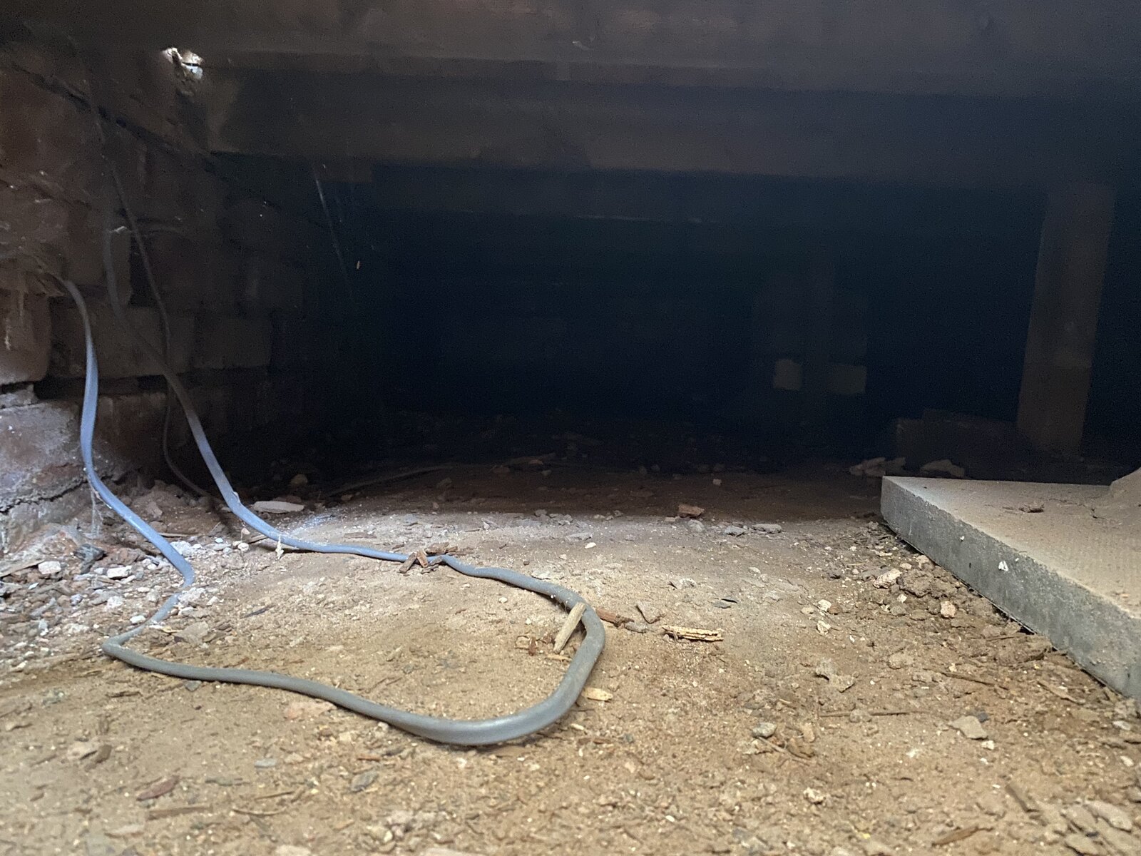

Vapour barrier needed for laminate on suspended floor?
24 Jul 2023
12
Hi, I’m going to lay some 12mm herringbone laminate in my hall way and I’ve got either some arbiton Fan-folded Sprint Laminate underlay or green wood fibre type in the house that I can use. Neither has vapour barrier properties. Do I need to worry about buying a vapour barrier or not. Floor is suspended tongue and grove, approx 30 years old. Picture of crawl space beneath also attached. Thanks!
Not my area but I did. Moisture form under could effect laminate.
Foil underlay or plastic will stop any trouble
