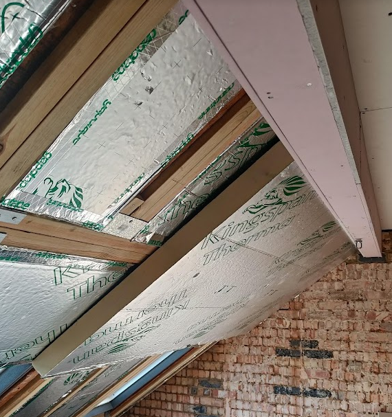

Hi all,
I am about to board out a cold roofed room. I have 75mm PIR between the rafters and another 75mm layer of PIR under the rafters.
Will the additional layer of PIR on the warm side be sufficient for vapour control - or do I need to still attach a VCL film? If it's the latter, what is the accepted way of attaching this VCL to the PIR?
If it's a continuous layer of foil backed boards then just tape over the joints with some foil tape. The purpose of the foil on the insulation is to act as the VCL.
Agree with above
