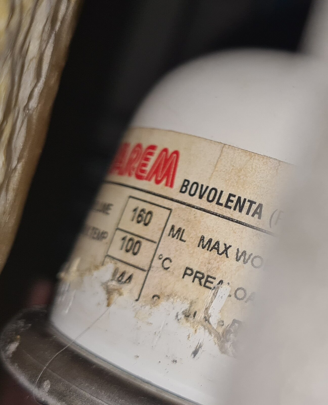

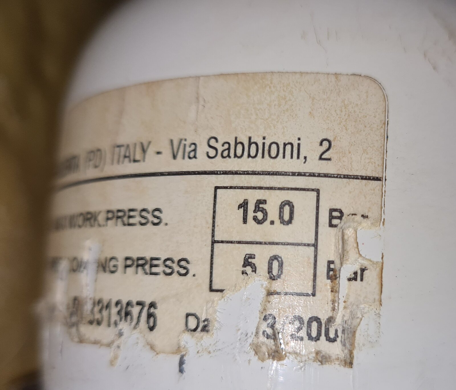

I have a Varem 0.16l mini expansion vessel/shock arrestor on the cold water inlet side to my thermal store. This cold water supply feeds the coil in my tank then exits the tank via a blender valve to give me mains pressure hot water at the preset blender valve temp. I've recently started to get some water hammer when things close off quickly, there is no pressure in this vessel at all. I have tried pressuring it up with a pump but I suspect the membrane has failed.

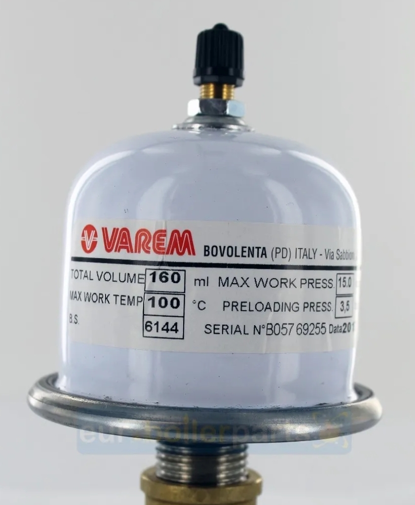

I'm going to replace it but I'm struggling to find one with the same spec. Current one is preloaded to 5 bar I only seem to be able to find a replacement that states preload 3.5 bar, everything else appears to be the same values, will this be ok?
Two of the images are of existing vessel but very difficult to get a picture, other is replacements that keep coming up when searched.
