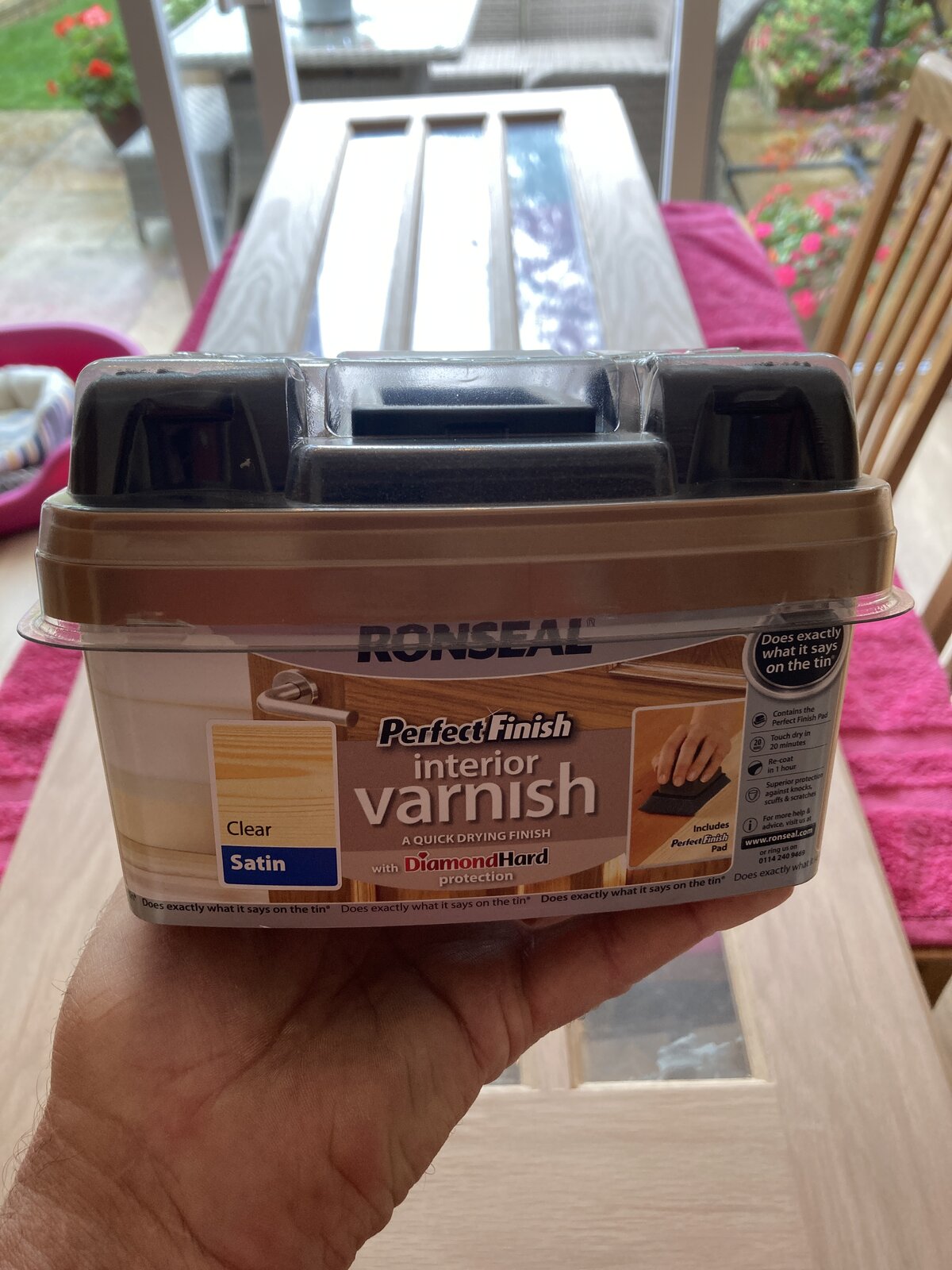

I’ve just had a pair of oak veneered doors delivered and it says to treat them straight away with 'varnish suitable for veneered doors'. I will have to go out and buy some. Is there such a thing? Aren’t they all just 'varnish'? Will it specifically say on the tin that it’s suitable for veneered doors?
Well, I went ahead and bought this anyway - didn’t have any choice whatsoever at B&Q. :rolleyes:
However, having read horror stories of laminate lifting off after being varnished, I phoned the technical helpline on the label before using it. What I was told was that as this was low NOX (I think that’s what he said), it was water based so will be perfect for wood laminate. I was told it’s the solvent based varnishes that can weaken or dissolve the glue holding the laminate on. Just thought I’d report back in case anyone else searches for it.
