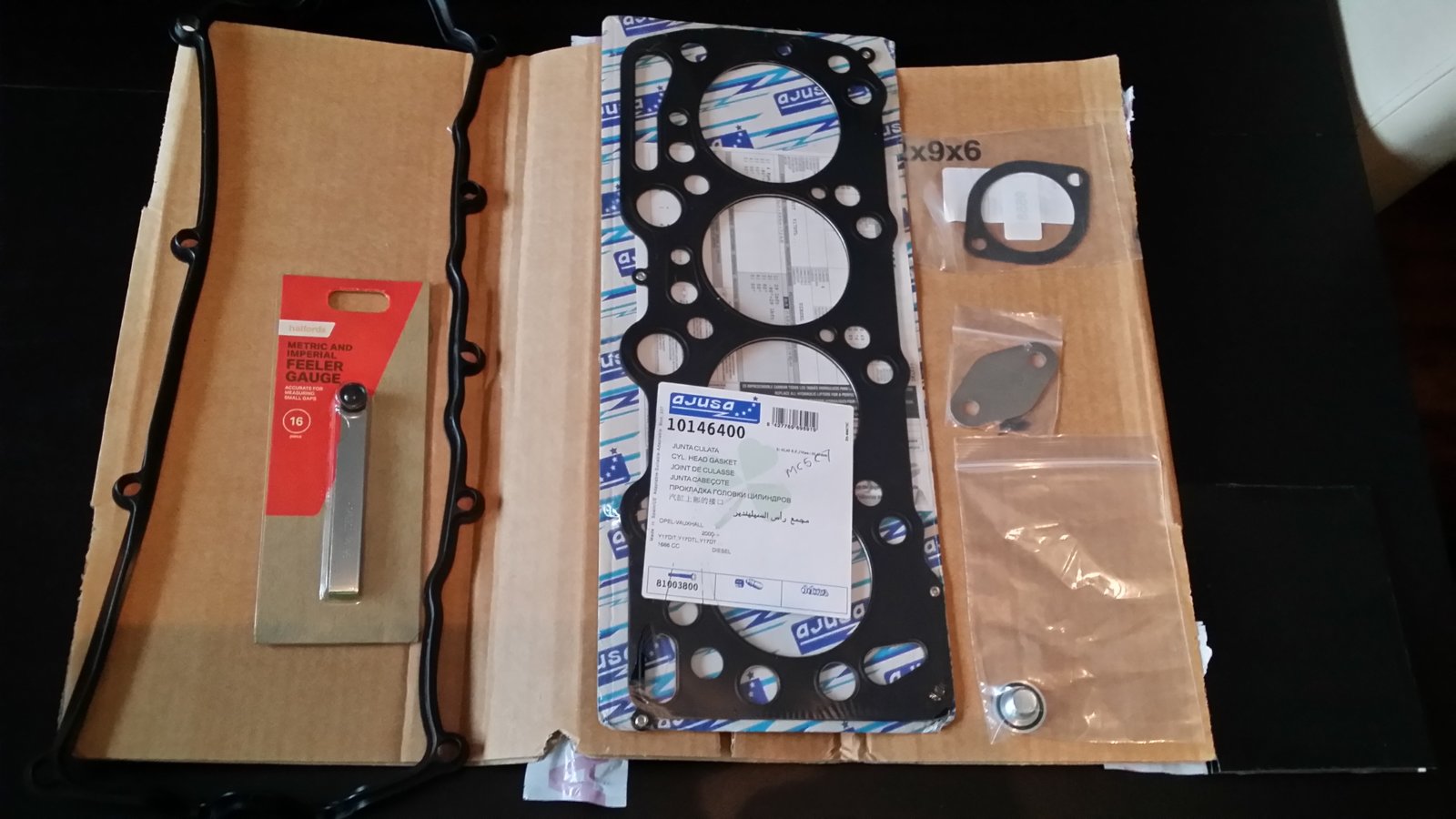

I have now bought the gaskets etc to attempt the head removal and if cracked, warped I'll go to plan B. £80.00 off Eb*y.
Otherwise slap it all back together with new head gasket, cross my fingers and hope she lasts.
Will also replace themo and fuel rail washers.

Waiting for the rain to stop so I can start the project.
New sump plug and EGR blanker. :)
I'll attempt to clear the leaves (tree) from the firewall so water can stop wetting my foot well.
