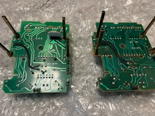

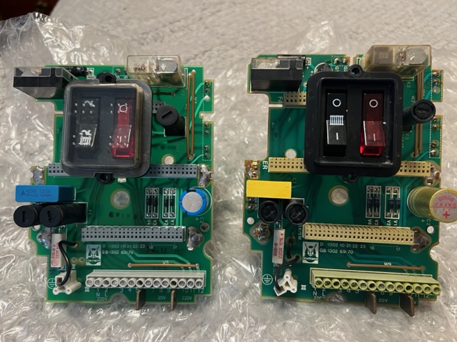

Anyone know what this difference is for on the new Main PCB board for a vcw gb 242 eh?
The new board is on the left and the thing I am referring to is the white 3 pin plug on the board bottom left.
The plug was attached new as shown (making connection to position II which goes nowhere)...whereas the plug on my old board was making a connection to position I which goes off to the thermostat wire named 4 (there is 3 & 4 on the board for attachment of the thermostat)
Plus on the back of the new board there is a piggyback connection board to connect further lines on the bottom daughter board connection.
Be nice to know what the change is for and if I need to place the white plug in the same position as the original board.
Thanks for any help.

Dp, thanks for the input, I agree the boiler is a tank and is 1988-95 build. The old girl is still looking good with quite a few new parts over the last 35 years. There are bound to be a few more parts go wry and hopefully not the expensive ones. I found the answer in my VCW manual as above. The plug needs to be in position 2 same as the old board. Have a good week guys.
