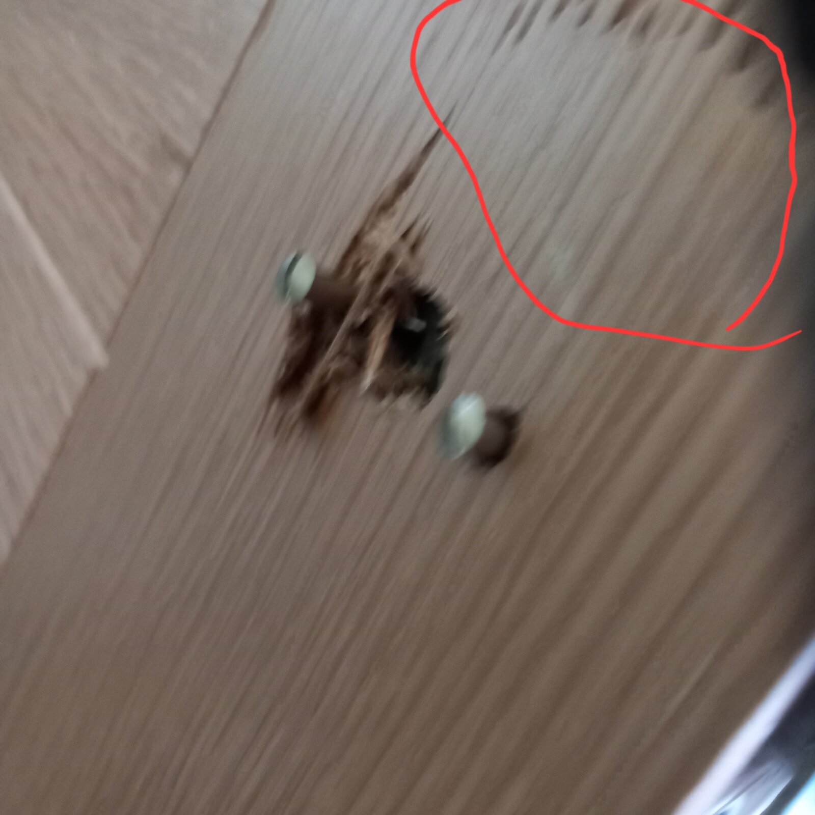

Had some grief with this type of door, when I was chiselling out the mortise latch the side kicked out near the spindle. Never has this on the cheap panel doors. Also found the wood splintered on the edges (on top of door)from my planing. Smaller chisel for latch recess?

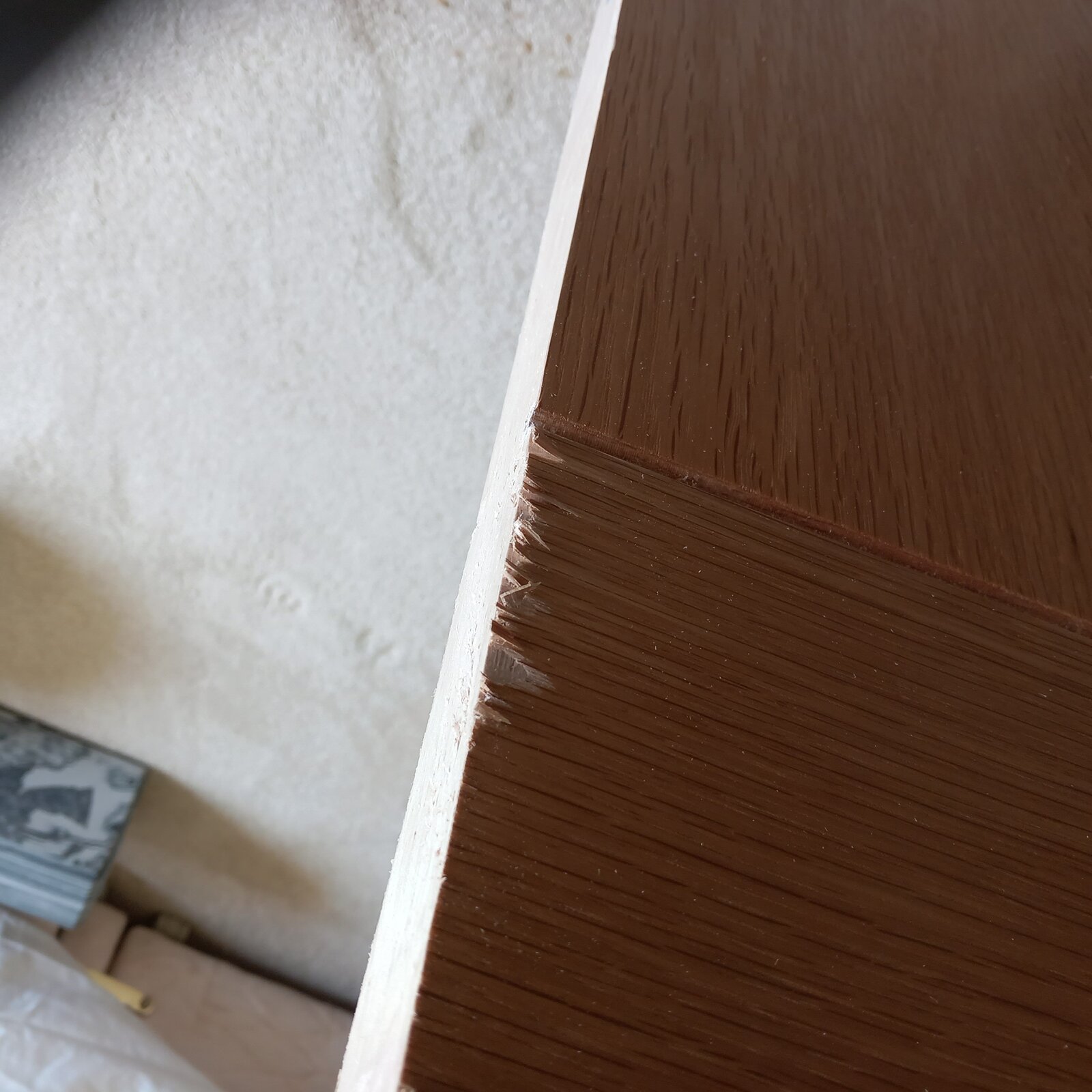

The edges splintered too down the sides.

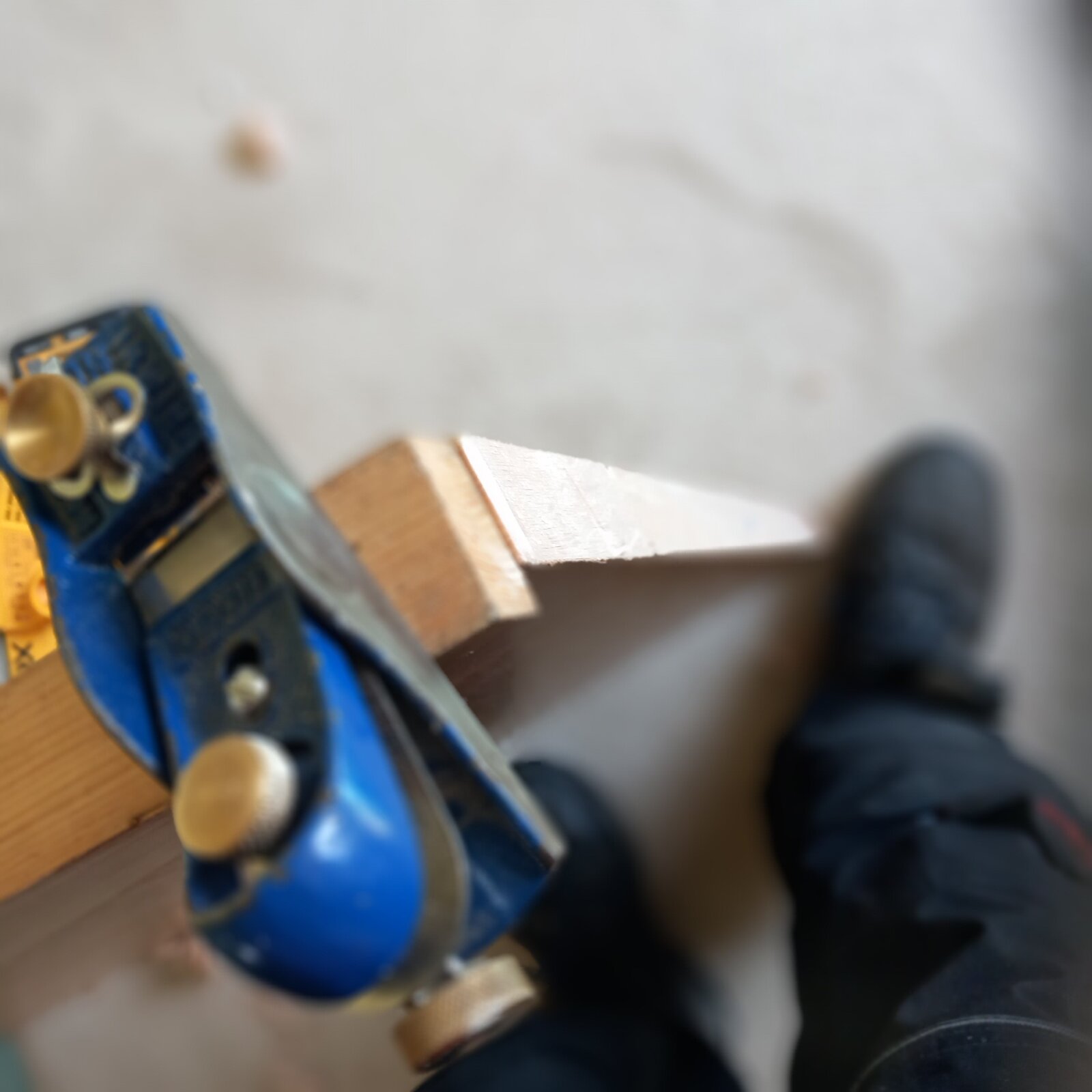

Best to plane with wood at top as in picture? I forgot my large clamp and just using block plane on top splintered sides!!

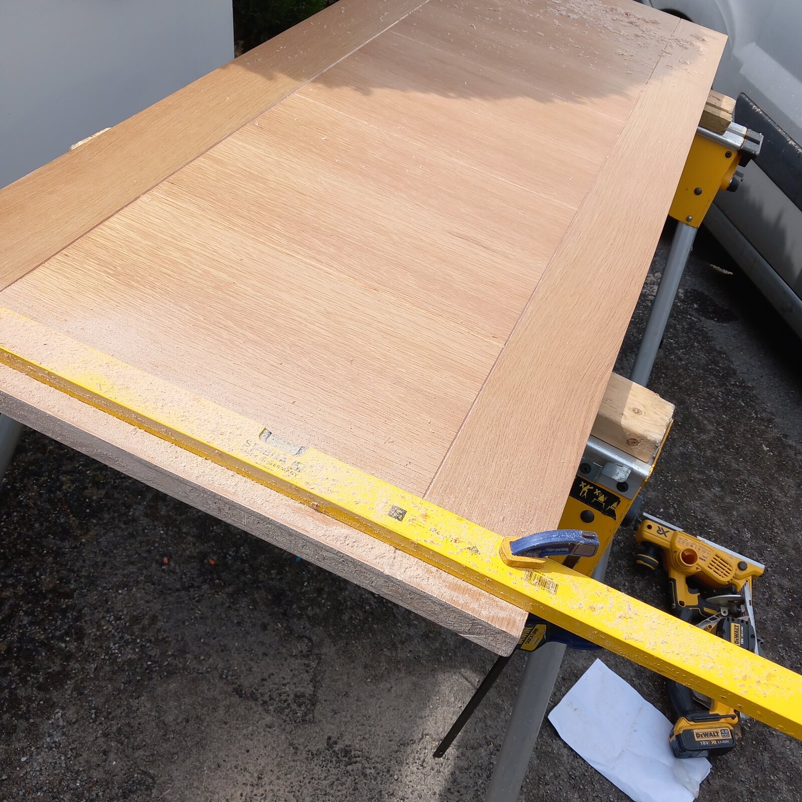

A track saw is the goto tool for shooting in doors these days.
Veneered doors are a bit of a nightmare - especially where the core is chipboard.
You will struggle trying to shoot in with a block plane.
One way to avoid break out is to run around both faces and edges with a Stanley knife first - splinters that form will stop at the knife cut.
You could run your knife cut 1mm beyond your shooting in - and then chamfer the door edge after.
Dare say it's because the edges are softwood with some kind of fibrous engineered wood (MDF) over; that's not going to splinter. Veneer is much easier to splinter, and you need to avoid pushing it in a direction where it has no support: don't run a plane off an edge, run it onto it so you're pushing the veneer into the door wood rather than into free air

Regarding the lock which the side split out from my chiselled being hammered in would a smaller chisel or smaller drill have worked better?

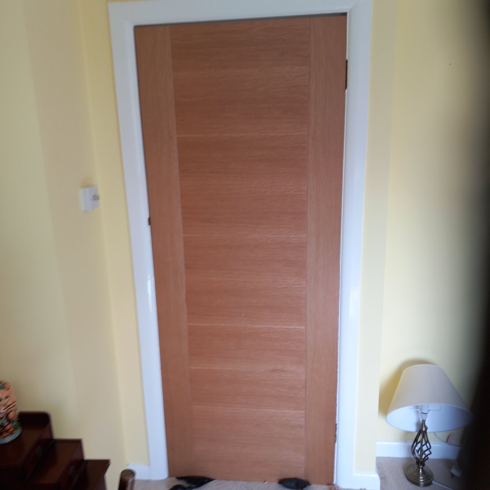

Track saw rather than planed? Surely if the lining has a belly or all over the place running a tracksaw wouldn't work?
You are right - at least for show veneer faced doors, where only the heavy cuts (if required) are done with the saw. However, if your casing is a over the place it can be more productive to remove the architraves, straighten/sort out the jambs (especially on the hinge side), refix the archis THEN hang the door because it is risky planing-in veneered doors. That is what a PRO would do.
Regarding the lock which the side split out from my chiselled being hammered in would a smaller chisel or smaller drill have worked better?,
Knifing (scoring) the lines, then a SHARP chisel, starting with the cross grain cuts would have been the way to go. But I'm sure I've told you this before
