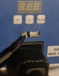

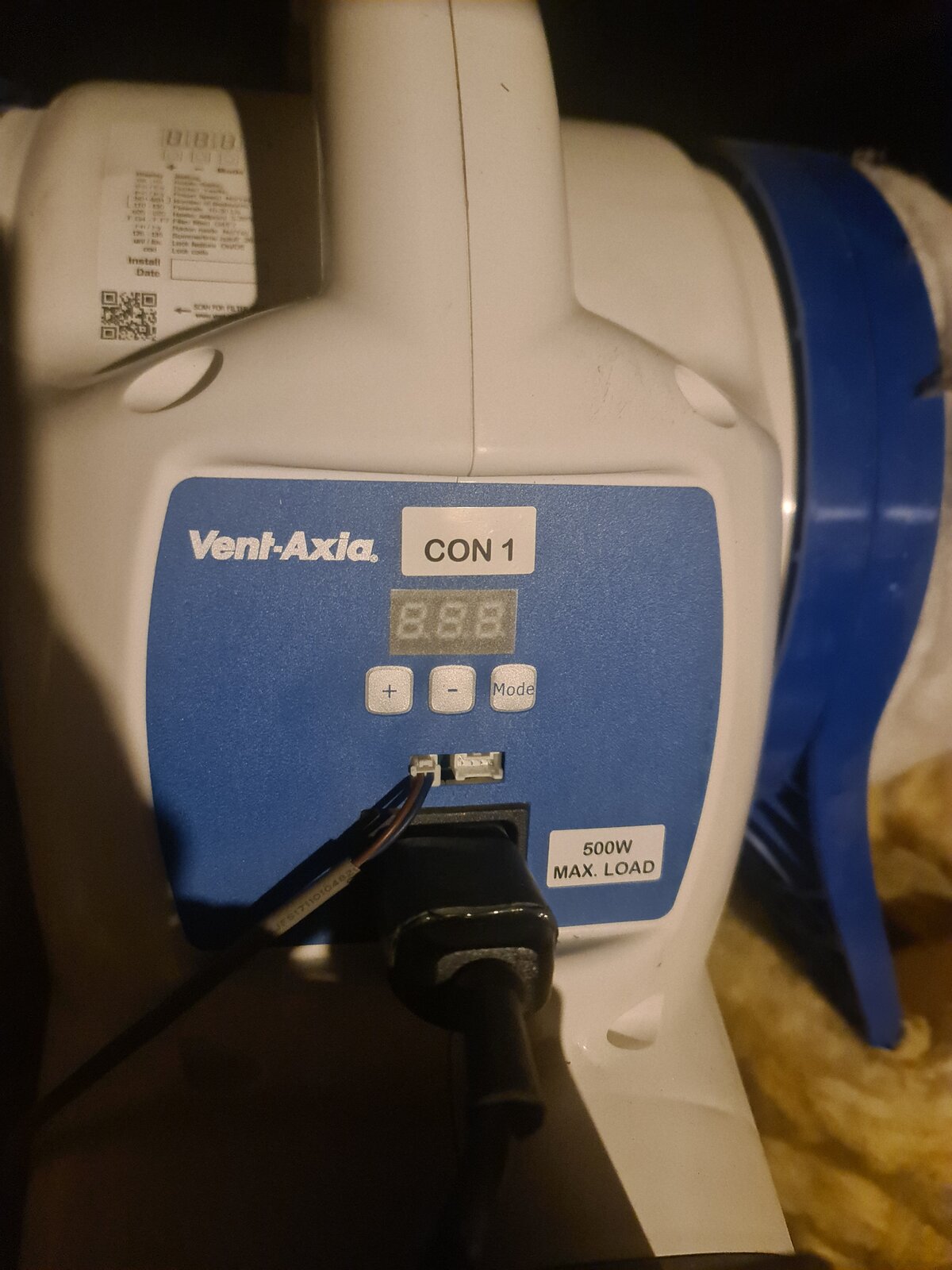

Hi, iv recently bought a vent axia piv unit. Iv noticed there is a space on the unit where a plug goes possibly for controls. The problem is I cant find any controls for it online, I wondered if there was anyone who could point me in the right direction, or if its not for a controller then possibly tell me what it is.

If you look at the picture of the unit at the start of the install instructions it only shows one socket above the mains outlet. The only mention of 2 sockets that I can see are on page 5 where it mentions installing a heater. My conclusion was that it is something to do with fitting a heater. The only other thing I can think of is that it is something that had a use but is not now on new models.

Hi Mike
I came across this thread as I'm trying to source this exact plug.
It's for a manual boost control p/n 411150
Wiring instructions are on page 10 of the manual https://asset.eezybridge.com/ba7b9546-29dd-40c4-87a7-885627281b87/VA_LC_PureAir_Home_FW.pdf
I'm looking to make one myself as I think the price for this simple cable is a bit on the high side. I notice someone on Reddit was also asking after the connector name, with no luck
I'll be sure to update you if I find out more.
It looks like a normally-open (obviously) circuit across two of those four pins, when the circuit is closed the unit goes into boost mode. In programming you can set the boost overrun time 0hr, 1hr, 2hr, 4hr, 8hr.
So you could wire a simple light switch to this and have overrun on 0hr, meaning the unit will boost when the switch is on and return immediately to trickle mode when the switch is off. Or you could wire a doorbell button to it to activate whatever overrun time you set in programming.
Quite handy to have but I'm not paying £100+ for that. Bit more info here, but they're getting into a more fancy Zigbee set-up https://community.home-assistant.io/t/volt-free-relay-for-vent-axia-fan-boost/647242

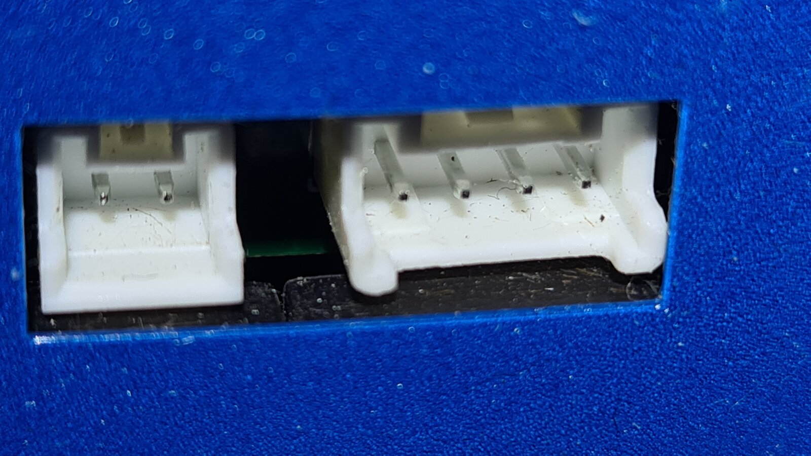

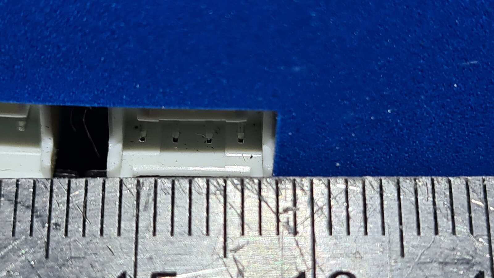

The OP in that thread was able to bodge a connector but mentioned he thought the proper connectors were JST-GH. That can't be right as the pitch (distance between pin centres) on those connectors is 1.25mm and I've measured the Vent-Axia ones at 2mm...

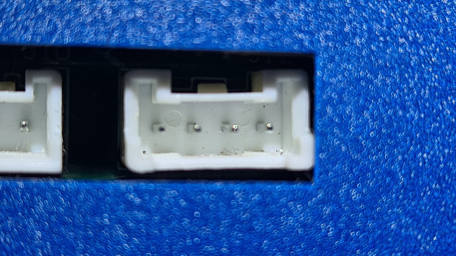

Some more close-ups of the sockets...

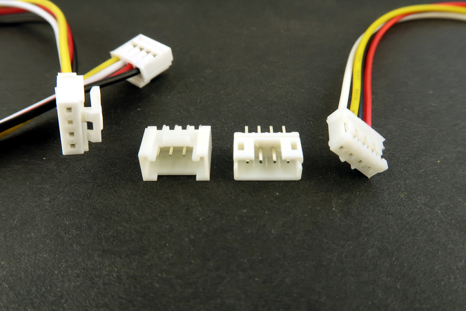

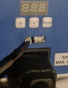

I've done a fair bit of Google-Fu this evening to find the connector. The JST-PH (shown on the right in the below picture) has a 2mm pitch but the connector shape looks quite different and there is no top-latch variant. The connector on the left is the Seeed Grove and looks close enough for me to chance around a fiver for a pack of 5 plugs with 50cm tails. If it's not quite right I'm sure a fresh Stanley blade will make it so.
Link to pack x5 50cm plugs https://www.ebay.co.uk/itm/132661875585 50cm isn't going to get me from the PIV unit to where I want the switch to be but I'll splice it onto whatever 2 core I have lying around. 0.5mm² flex would be fine.

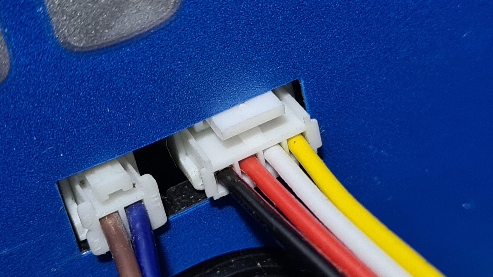

The Grove connectors arrived today and they do fit, bit of a squeeze as the top latch interferes slightly with the edge of the aperture but I think it will work.

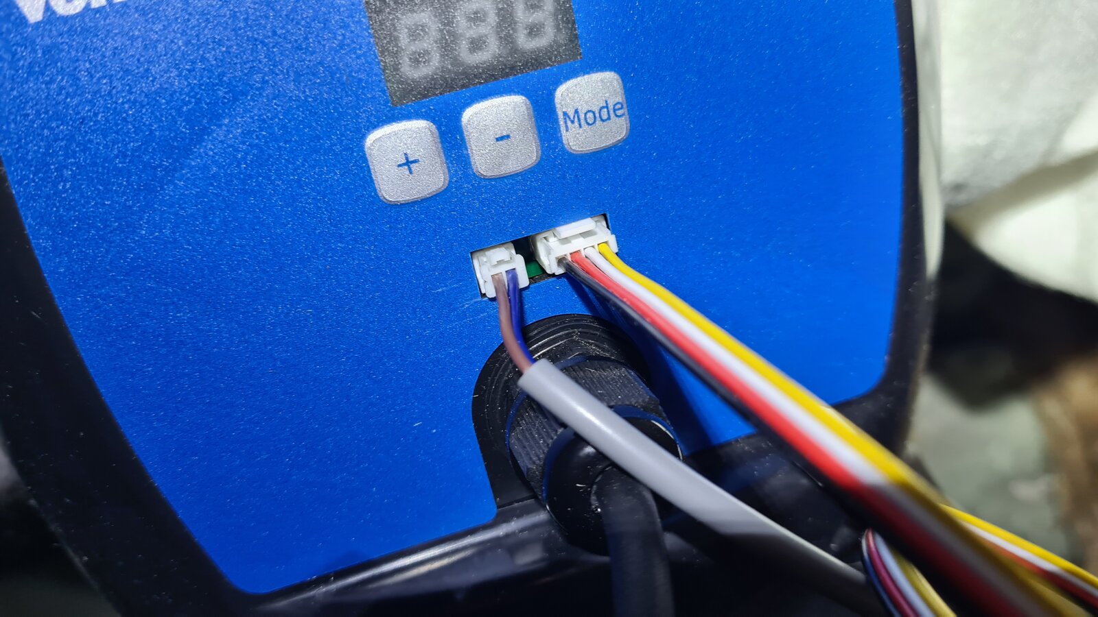

Finally got time to wire this up and test it. The outside 2 pins are the ones to use (pins 1 and 4, black and yellow on the leads pictured above). Works perfectly and saved a fair few quid compared to buying the official kit.
Found this thread last week and ordered the Grove cable but also some JST-PA connectors. Took the wires out of the Grove cable and put them in the JST-PA connectors and they fit perfectly in to the vent axia unit. They're pretty much the same as the grove ones but the latch is smaller.
