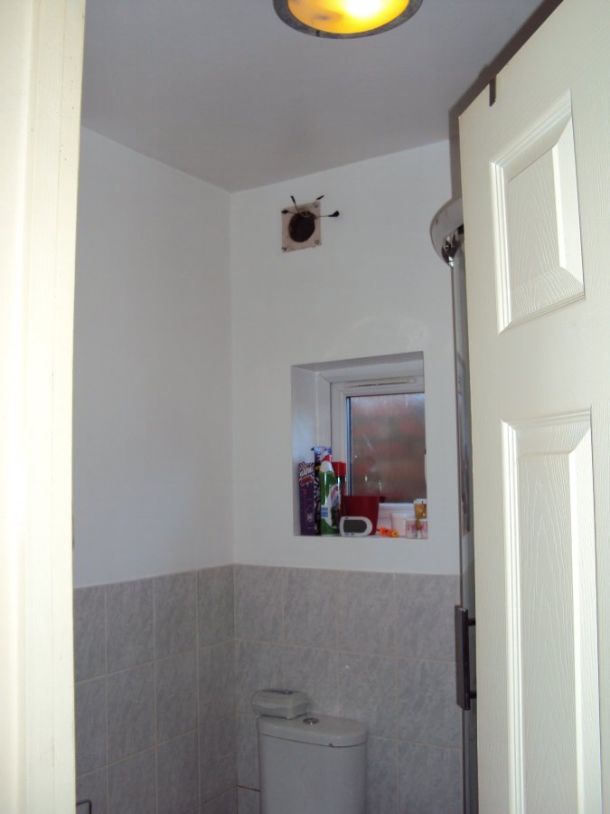

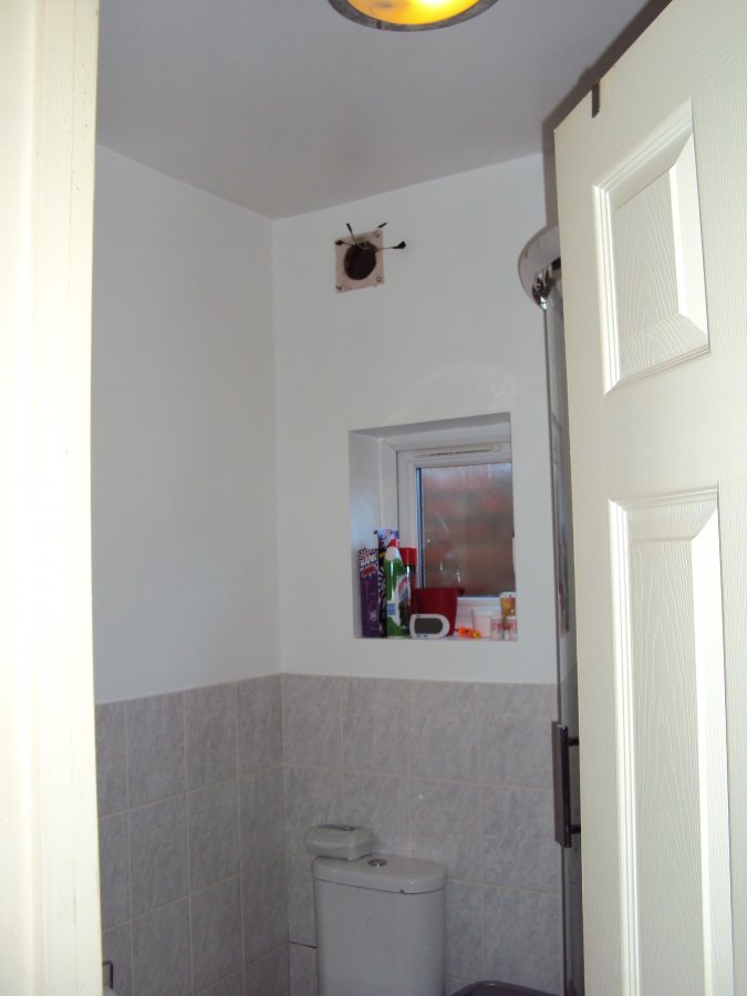

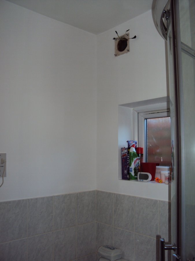

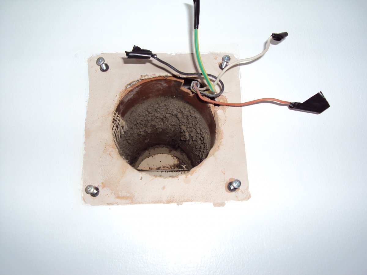

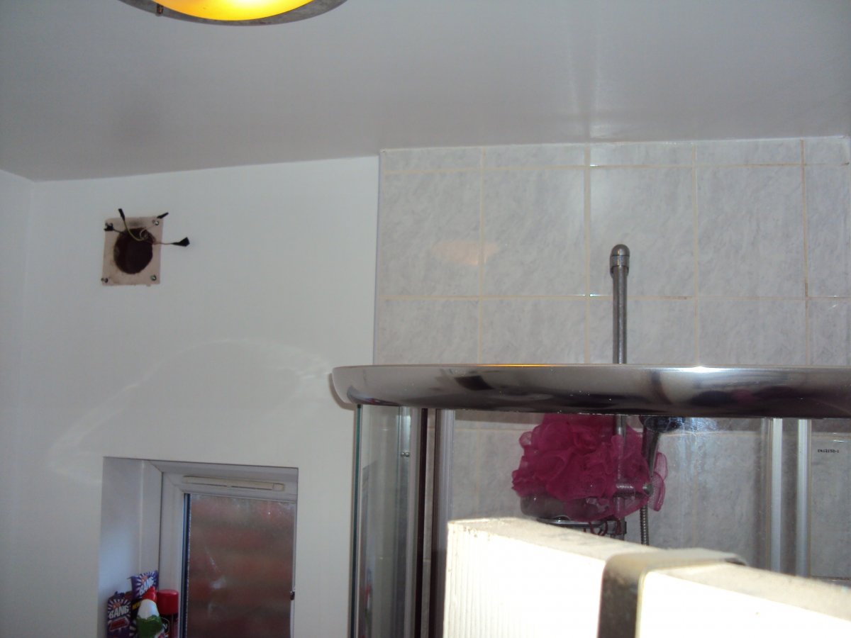

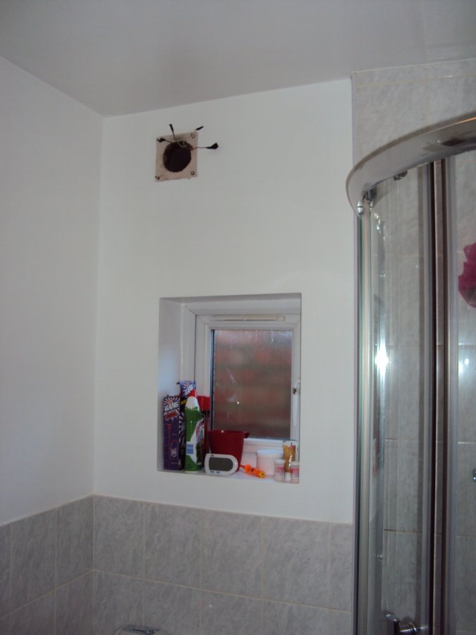

Hi all,
Got a bit of a tricky situation, and would appreciate input from forum members.
(Ventilation seems to be an area, which is often overlooked, given its importance)
Pics included.
Room: Wash basin, toilet, shower cubicle (No bathtub).
Room - Dimensions = 1.81m long by 1.74m wide by 2.53m tall

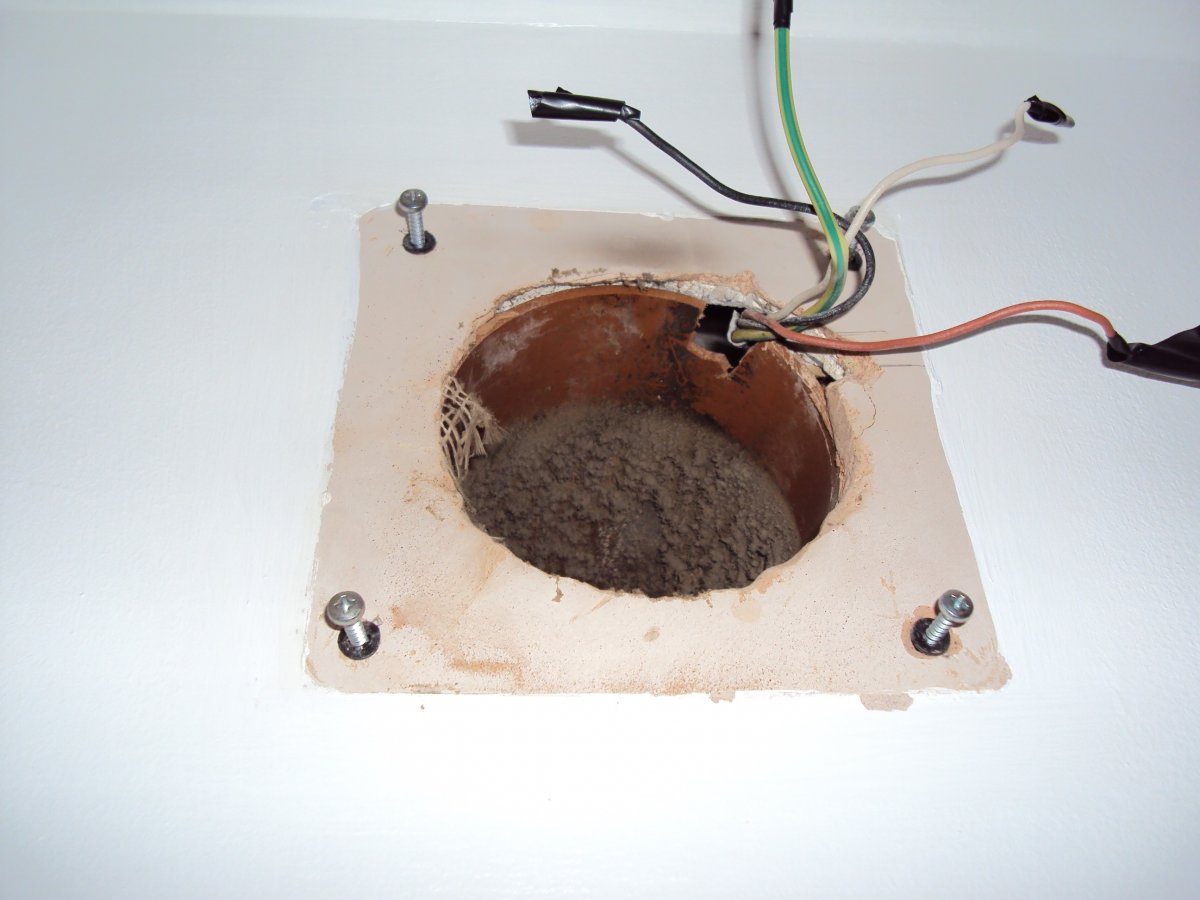

Exhaust ducting = 100mm diameter by 300mm long.
I used this to do the calculation - but I have no idea if it is out of date - or is wrong. It suggests that I absolutely need a 120mm fan. Don't know how seriously to take it.
So -
1. Clearly it would be very easy just to put in another 100mm/ 4inch fan, but there must be a
reason that a larger one is suggested? Would it really make a significant difference?
2. If a more powerful/bigger extractor is needed, what might be the simplest solution here? Is there a way to couple a larger fan say 120mm/ 5" fan, to this 100cm existing tube, and have it work out okay? (I'm hoping to avoid replacing the exhaust tube with a larger diameter one).
3.What brand of fan/extractor would you recommend?
4.Any thoughts or alternatives you might care to suggest or that come to mind?
My thanks to all that contribute
SirLancelot
I have a similar sized bathroom and I use a 4" fan too.....but I'm meticulous about using a squeegie to dry the shower walls every time.
I use a Manrose Gold fan, with timer - and it runs for maybe 20 mins after switching off. Sometimes I let it run for longer.

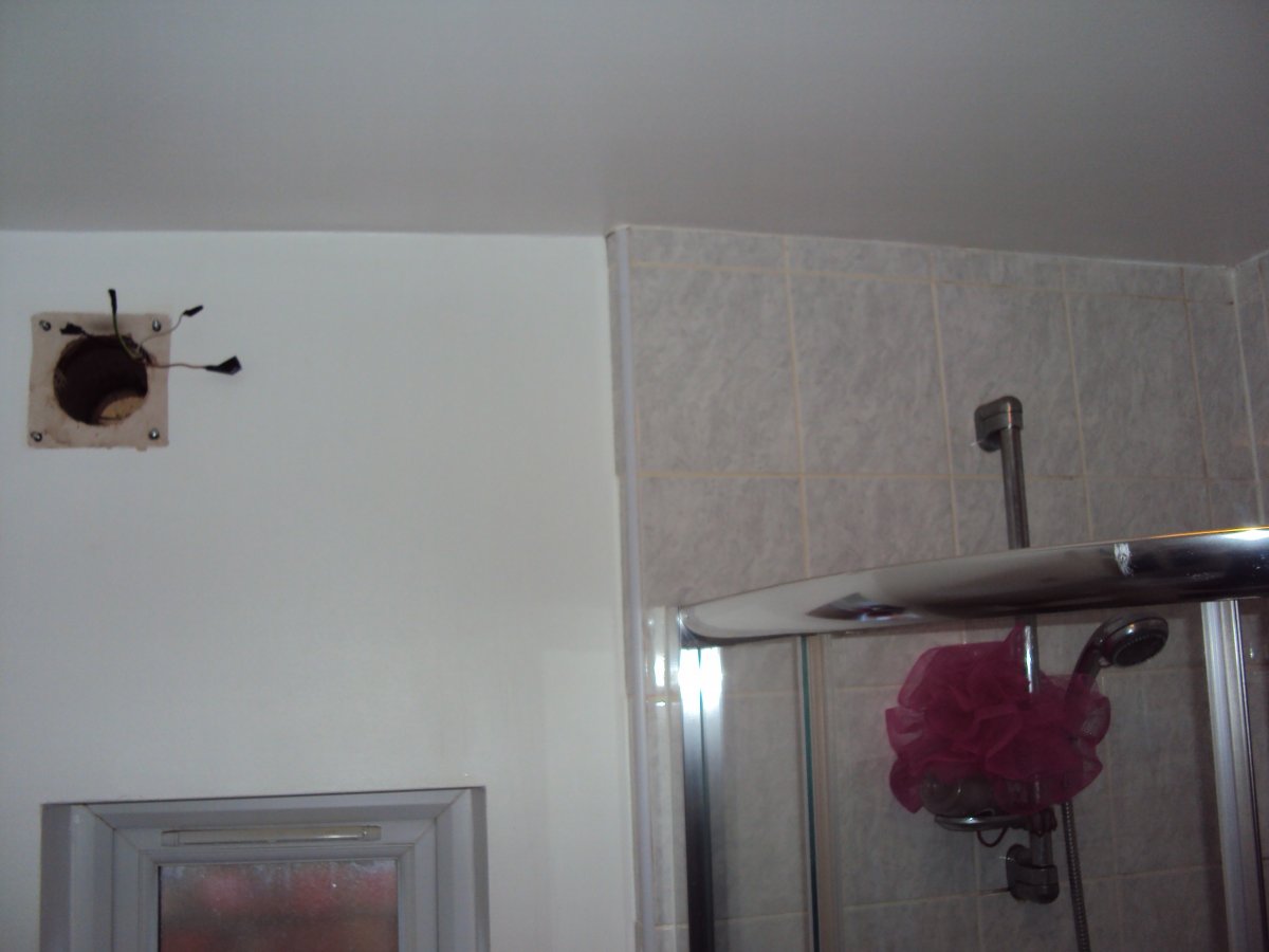

Looking at your wires there, there could be two lives, which you will need for the timer fan - one switched, one not.
John :)
Why do you think that you need a bigger diameter fan?
It's all down to air changes and efficiency. A 100mm centrifugal fan is more efficient than the same diameter axial fan for instance.
4 inch is fine - clean the duct and make sure that one way flap is free to move
Install a Vectaire MF100C centrifugal fan and avoid cheap axial fans. Also, and this is critical, get it wired to run continuously on trickle speed with the boost speed wired to the lighting circuit, running timers and humidistat switches are a complete waste of time and you want to be dealing with air changes in the property over a 24 hour period not just switching the fan on when you shower or bathe.

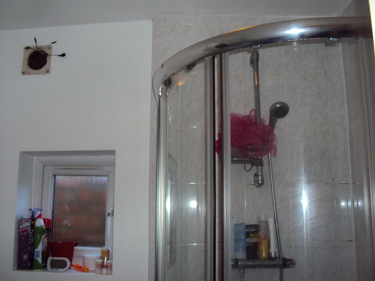

Part of the problem may be the trickle vent on the window is almost directly below the fan. This will cause a 'short circuit' of airflow in through the trickle vent and out through the fan, bypassing the shower area completely.
You might find an improvement if you close the vent and leave the fan running relying on makeup air through under door ventilation from the rest of the house.
Or put a (safety extra low voltage) fan above the shower
Yes, this is a problem, if there is a trickle vent in the same room then it should be closed or it will indeed short circuit the extraction process. Fans are meant to draw air from other rooms and not from the room they are located in.
