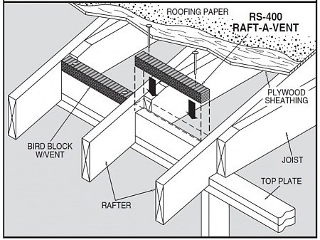

I have now realised that the eaves tray will be laying flat on the 6"x1" timber so even with over-fascia vents and the rafter roll the air flow will be blocked.
I am thinking that maybe I will have to install something like another set of over-fascia vents under the rear of the eaves tray, raising it off the timber and so creating the air flow passage.
What are your thought please ?
bobsuerita, thanks I've scrolled through Keymer.pdf and I am still digesting it.
Regarding the noggin vent.jpg not sure how this can be applied with my open eaves roof.
