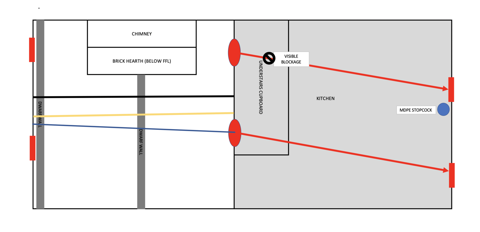

I have a 1920's terrace which has a wet rot problem in the suspended timber floor in the lounge. The kitchen (to the rear of the lounge) is a concrete floors and have just fitted a new kitchen and kitchen floor (d'oh!).
Wet rot is at it's worst on either end of the timber joists (obviously) but the back of the floor has mould growing under the floor - front is just wet. The subfloor is just exposed clay (once I've cleaned 100 years of debris out anyway)
I've got 50% of the floor up and both front facing air bricks are clear, but the two salt glazed pipes that run from the dividing wall to the rear of the house for exhaust (or intake I guess depending on the wind direction!) are both blocked. One appears to have collapsed and the other, has been butchered by the water company - new MDPE main has been brought in at some point in the past and to make life easy they've gone straight down the duct and come up in the kitchen floor nowhere near the air brick - so have presumably destroyed the duct in the process.
As I see it I have a few options:
1. Replace with tanalised timber & celotex and worry about it when the kitchen gets redone.
2. Mechanical ventilation
3. Hardcore, concrete, celotex and screed the floor.
4. Block and beam.
If there are other options then I am open to suggestions. I suspect 3 & 4 are the most expensive options and 2 would require fitting the ventilation somewhere accessible. Option 1 is clearly the cheapest but I like to do things properly where possible
Rough drawing for visual representation attached.

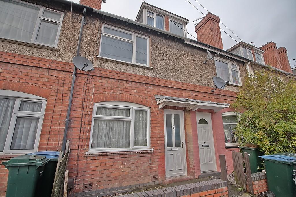

so would pics of the rear & front elevations?

sketched diagrams need to be fully annotated for the reader to understand.

Re: the diagram, the red is air bricks/salt glaze duct (route is unlikely to be accurate as they curve). Black is the PILC electric main, yellow is the new-ish gas main and blue the MDPE water main.
Front Elevation

thanks for the images - but a little info with each pic helps the viewer orient himself etc.
the front & rear air bricks appear to be too high to be useful - do they somehow vent the sub-area or do they simply vent the upper rooms above the FFL's?
the rear airbricks cannot, as far as i can make out, be venting through the salt glaze pipes you mentioned?
the cause of your damp difficulties is condensation due i'd say from a lack of through ventilation.

The air vents in the front wall are connected by missing bricks to the last photo, just an opening in the wall that makes it's way up to the air brick (no cavity obviously) I'm assuming it's just working like a telescopic air brick but without this new fangled plastic. There are no vents in the front room certainly, but now I've looked back through photos, the smaller air brick on the left of the back door is a room vent.
